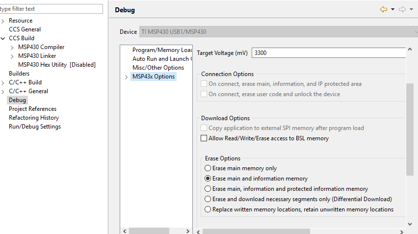

I've been happily(?) "debugging, loading & rectifying code" over & over for a while now & was busy doing the same yesterday when suddenly on one download cycle i got the message "Trouble Writing Memory Block at 0x1800 on Page 0 of Length 0x200: Could not erase device memory". Changing project settings didnt help, connecting disconnecting debuggers & board didnt help so i gave up leaving the board disconnected to power.
8 hrs later i come back & being the eternal optimist i retry & voila! it loads!

As it is i AM using the infoD memory. I have an initialised structure in my application that utilises that space...but it hadnt changed in the last week...

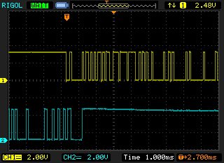

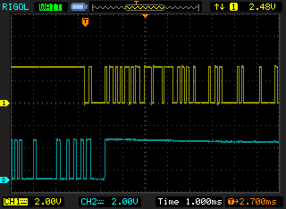

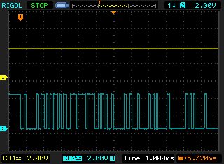

The replacement board i was using packed up on the Tx side!...below is the waveform of both the Rx & Tx (Tx in yellow & Rx in blue) after it packed up & then with another board where the same comms produced correct signals..
What has happened to the Tx side to produce such an output???...its almost like the Tx is mimicking the Rx.
The correct signals came from the board I reconnected that was the cause of this thread & whose Rx side had previously packed up (see 2 msgs up)....but its now working perfectly (so being off mains for a few days resolved its issue)!! i have now kept it connected to mains and will see if it packs up again in a few days time.
I would suspect an open circuit on the Tx such that the Tx trace is not being driven, and the scope picks up an low-level impulse when the Rx signal changes.moshe jacobson18 said:What has happened to the Tx side to produce such an output???...its almost like the Tx is mimicking the Rx.
Maybe there is a dry solder joint / cracked PCB trace such that the Tx connection is intermittent.
thank you Chester...there was!
in fact, looking under the microscope, i could see the pin move when i nudged it!!
