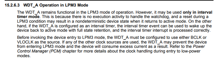

  • After looking into this a bit more, this section in the TRM might be of use.
    Have you tried using BCLK or VLOCLK? I believe this may be a more accurate cause of what you're seeing, but I'd be interested to know what you see.
    I also assume you used this as a reference?: processors.wiki.ti.com/.../TI-RTOS_MSP432_Timer
  • Hello Evan,
    the link processors.wiki.ti.com/.../TI-RTOS_MSP432_Timer was exactly what I used to build my test application. Thanks for your reply. I read the extract of the TRM and changed the line
    WDT_A_initIntervalTimer(WDT_A_CLOCKSOURCE_ACLK, WDT_A_CLOCKITERATIONS_64)
    in my main to
    WDT_A_initIntervalTimer(WDT_A_CLOCKSOURCE_BCLK, WDT_A_CLOCKITERATIONS_64)
    like described. This gave a compiler error because WDT_A_CLOCKSOURCE_BCLK is defined as WDT_A_CTL_SSEL_4 which didnt exists for MSP432! Then I changed BCLK to XCLK and it was compiled successfully!
    Now everything works as expected. The CPU wakes up periodically calls the notifyfxn and goes to sleep again.
    In MSP_EXPP401R_initGeneral I init ACLK and BCLK with LFXT using
    CS_startLFXT(CS_CTL2_LFXTDRIVE_1);
    CS_initClockSignal(CS_ACLK, CS_LFXTCLK_SELECT, CS_CLOCK_DIVIDER_1);
    CS_initClockSignal(CS_BCLK, CS_LFXTCLK_SELECT, CS_CLOCK_DIVIDER_1);
    So everything looks like I am using external 32kHz oszillator and not internal VLOCLK.
    At the end of my "Hello" Task I screw down the watchdog interval using
    WDT_A_initIntervalTimer(WDT_A_CLOCKSOURCE_XCLK, WDT_A_CLOCKITERATIONS_512);
    This reduces the supply current to 68µA which is okay for the test.
