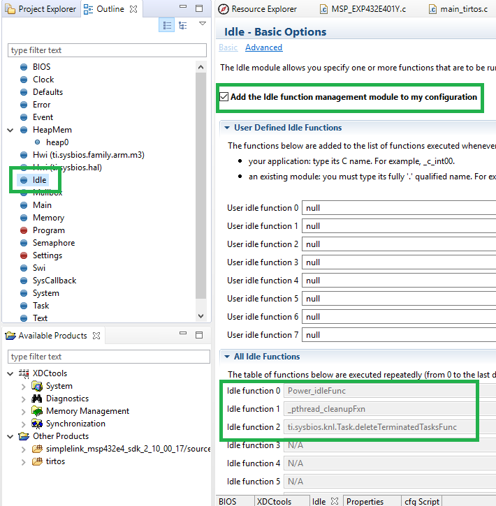

I am porting firmware from TI-RTOS to SimpleLink / POSIX API (with TI-RTOS as underlying RTOS).
In TI-RTOS before impleLink, you could configure that when no task was running, an idle task would run and move the controller to a lower power level (via the TI-RTOS configuration GUI).
Is that same functionality available in SimpleLink for MSP432?
Asking for this exercise on element14 community blog series:
https://www.element14.com/community/people/jancumps/blog/2018/05/05/switch-from-ti-rtos-to-simplelink-posix-threads-and-semaphores
  • Ah, I see that the RTOS project that's created has the idle functions set up:
    When I built an example, the ULP logged in the console that there's no low power used:
    remark #10371-D: (ULP 1.1) Detected no uses of low power mode state changing instructions
    I'd expect that the ULP would not give this message if Power_idleFunc() calls low power status.
