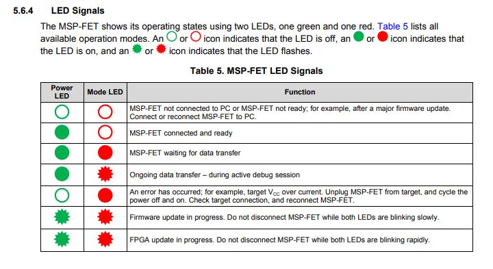

    so you only the the red light glowing on the MSP-FET, no green light, correct?
    Did you already check the explanation of the LED signals?
    You said "when i tried to again download the firmware" are you talking about application firmware on the target device or the MSP-FET firmware?
    Please share what you try to attempt while you unplug the cable on target device side.

  • Dear Sir,
    Mention below is the block diagram of my connection .
    1) when i connect cable 1 to PC and debugger then green LED glows in  debugger  and then  i connect cable 2 to device and debugger
    After this connection i have download the firmware to the device through debugger.
    firmware downloaded to device successfully.
    2) Now when i remove the cable 2 from device and debugger then Green LED is glowing.
    But After sometimes Red Led turn ON.
    2)Now when i connect cable 2 to device and debugger
    After this connection i tried to download the firmware to the device through debugger
    But Now i am getting error message that re-initialized failed in the firmware.

    What LEDs are on at this point?
    Can you check in your device manager if the debugger is connected and found by the PC? Can you unplug the debugger from PC and try again?

  • Dear Sir/Mam,
    Que: What LEDs are on at this point?
    Ans : Both LED are Glowing.
    Que: Can you check in your device manager if the debugger is connected and found by the PC? Can you unplug the debugger from PC and try again?
    Ans : In Device Manger ,
    I am getting message like unknown device .
    After third-fourth try i.e, unplug the cable from PC and then plugin the cable to the PC
    i am getting message USB composite device.
    Vai
  • Hi Vai,
    can you please check if your cables are ok? Please try different cables to make sure they are not broken.
    Andre
