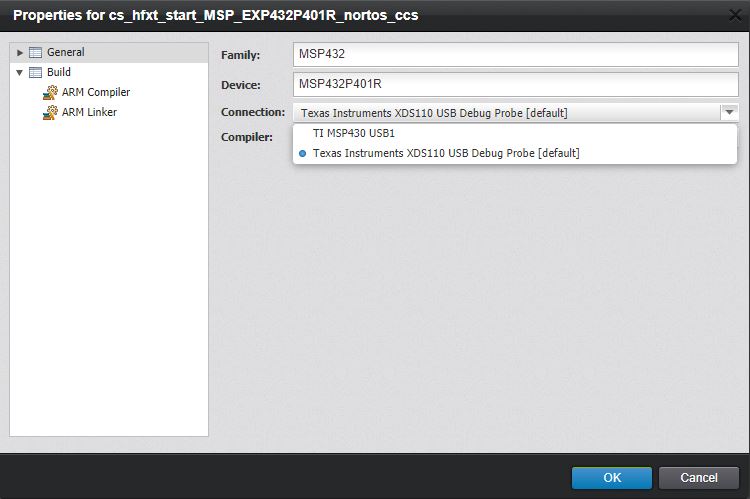

    Thank you for your message. I decided to test the FET. I have started an blinky project on https://dev.ti.com/ide  online IDE.
    I have connected the FET to my custom board. When I run the code it showing an error.
    Texas Instruments XDS110 USB Debug Probe/CS_DAP_0
    Error connecting to the target: (Error -260 @ 0x0) An attempt to connect to the XDS110 failed. The cause may be one or more of: no XDS110 is connected, invalid firmware update, invalid XDS110 serial number, or faulty USB cable. The firmware and serial number may be updated using the xdsdfu utility found in the .../ccs_base/common/uscif/xds110 directory of your installation. View the ReadMe.txt file there for instructions. (Emulation package 8.1.0.00007)
    Im sure that firmware is up todate because I have tested on MSP432 breakout board. Also Im sure that no other XDS110 is connected. I think this may be a problem of serial number. My FET serial number is  1705003C4.
    I tried to open the xdsdfu in the above mentioned folder unfortunately it is not opening. I deinstalled and try to install it. i see there are some errors while installing and then I clicked ignor. Is this the problem?. Also i did not find ti_emupack_setup for windows 64bits.
    Can you please suggest the solution?. Thank you.
  • In the project properties are you selecting the MSP430 USB?
    Thank you,
    Chris
  • Did you have any success selecting the TI MSP430 USB1?
    Chris
