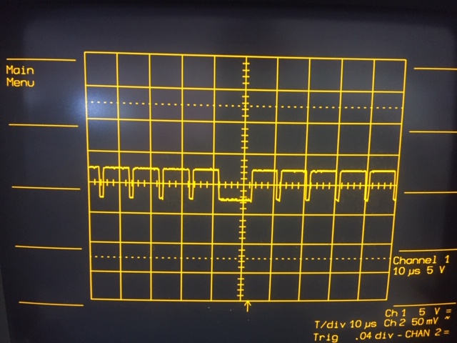

I'm trying to use relatively high frequency PWM on the MSP432 Timer A.  The PWM frequency is ~100kHz, and it's updated at a 20kHz rate, using the Systick interrupt.
It almost works, but the issue is that there is an occasional glitch in the duty cycle, probably when the duty cycle is updated.  This is fatal for my application, so I was wondering if there's a glitchless way to update the PWM duty cycle?  Or if that's not the issue what might be the root cause and solution?
I note that the MSP432 doesn't seem to have the double-buffered compare register structure that is typically used to avoid this problem, so I'm hoping that there is some workaround other than switching to a different device.  Thanks!
The glitch:
The code:  (Sorry, I'm an analog/power hardware guy, so probably not too elegant!)

  • Any update on this, or ETA for an update?  The glitch is indeed due to updating the duty cycle.
    JD
  • A  workaround idea:
    Have the same PWM signal go to an input pin.   Turn on the interrupt for that pin on the rising edge.  In the interrupt handler there, you write the new pulse width, then disable that interrupt again.  You turn on the interrupt for that pin only when you want to change the Pulse Width.
    I have seen the glitch on a different kind of chip before.  It happens when the pulse width count is past the new pulse width you are writing.  So the counter never equals the target number and the PWM just sails on past that number.  By having the interrupt on the rising edge out of the PWM signal and changing the PWM then, the pulse counter doesn't have the chance to be anything but ZERO while you're writing the new value.
  • Makes complete sense, thanks, I will give it a try. Thanks!
