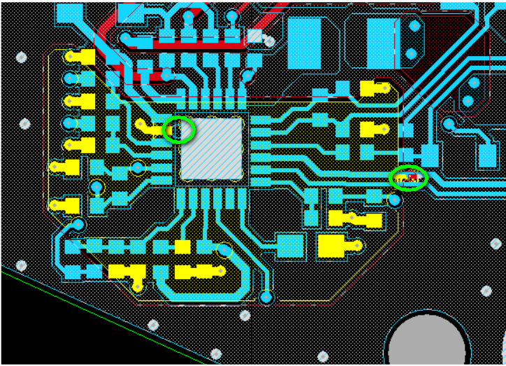

Please see layout guidelines below and let me know if you have any questions/concerns.
I will then review the layout and get back to you with feedback
Aya Khedr
Hi Aya
Can you help check about SC603 layout and feedback
I have the following questions to ask:
Use SP1 on Top to connect SGND and GND together. Is this OK?
Is it OK to connect pin17 and pin24 together in Bot?

Hi Gareth,
Overall, the layout looks good.
We recommend connecting analog ground and power ground together using the thermal pad as the single ground connection point. Or use a 0-Ω resistor to tie analog ground to power ground (thermal pad should tie to analog ground in this case)
