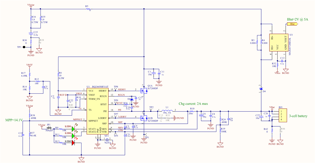

I’m using BQ24650 to charge a 3-cell Li-Ion battery pack and have some problems.
We overlooked the input RC filter. How important is it? Without it, will the circuit still work without protection?
Is D1 on the datasheet required? We are using a DC power supply instead of the solar panel.

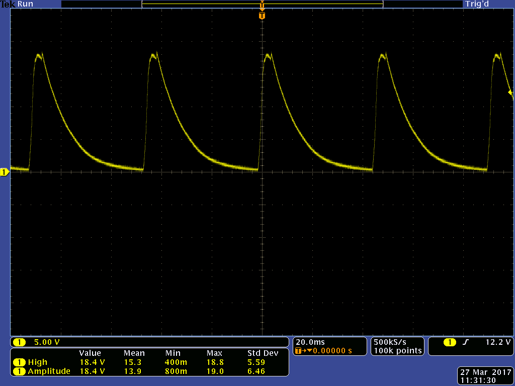

The attached is the scope capture of PH pin (14). The regulator seems to start switching, but only for a short period of time.

    The device will operate without the input filter. It will just be vulnerable to large input spikes.
    It is probably best to have a blocking diode after your input. Regardless of what your input source is, the battery has a direct connection back to the input through the high side body diode.
    Looking at your schematic in the document, I see that your REGN cap is only 0.1uF. Try replacing this with a 1uF cap. This will probably help the internal LDO stability when it tries to drive the low side FET.

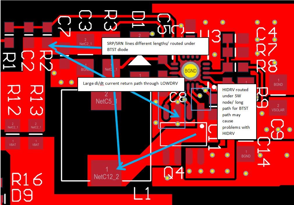

    I replaced the caps to 1uF, but that didn't help.  I begin to suspect if that's the layout problem.
    Layout capture attached.

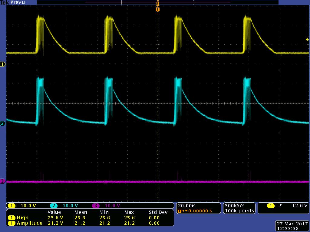

  • Also here's the BTST pin capture.
    If I understand it correct, that pin should display switching signal, but it only happens every 45ms or so.  Puzzled...
    BTST.docx
  • Shang,
    Thanks for the additional info. That's unfortunate that replacing the caps didn't help. Regardless, I would leave the REGN and VCC caps as 1uF for best performance.
    The BTST pin is not the switching pin, but rather the high side FET gate drive pin. The switching signal is actually at the PH pin. It looks like the converter switches everytime BTST drops 4V, which is correct.

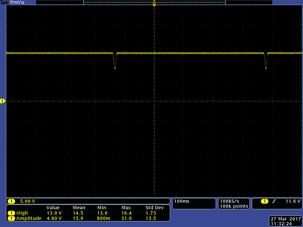

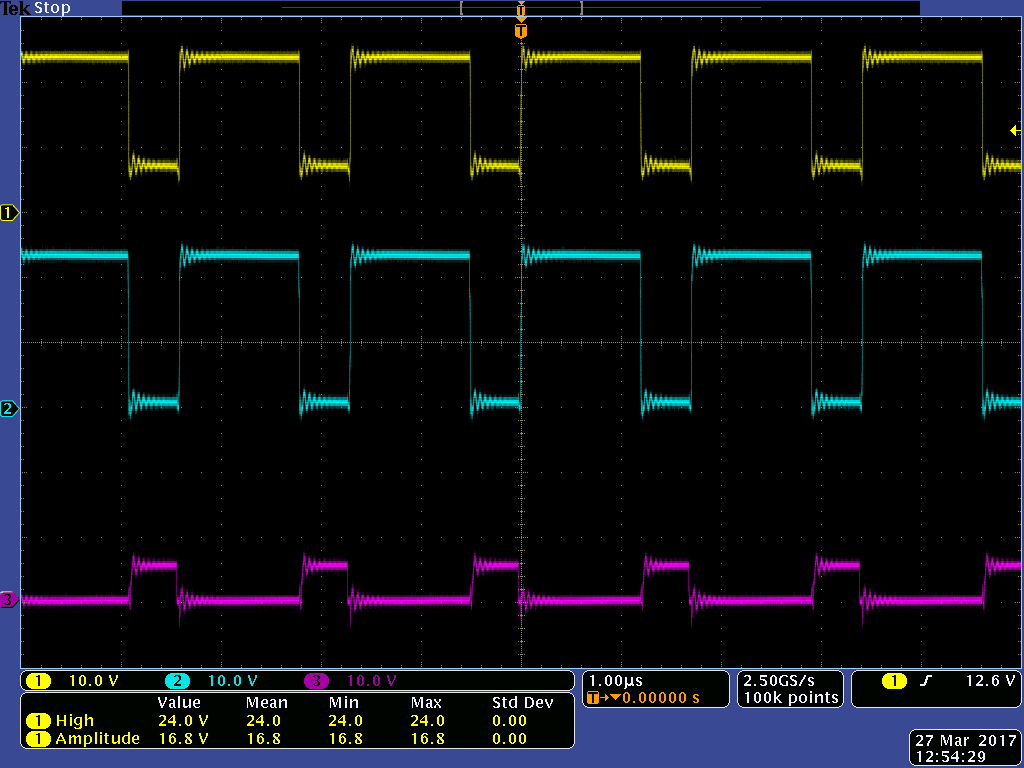

    Could you show me traces of high drive and low drive together? I am curious to see what is happening there. I only need to see a few periods. If I can see Vbat that would also be helpful.
    Could I also see a waveform of what MPPSET looks like with a battery attached?

  • Hi David,
    The screen captures are attached.  The diode polarity is correct.    We soldered the TS resistors on the board with a short wire (<1cm) and it shows 1.99V.

    However, your voltage at MPPSET is really interesting. That actually looks like the battery detection waveform. This makes me think that you do need the diode D1 on the datasheet. Was this waveform taken with a battery inserted, or without one?

    I also did some more measurement as attached.  It seems that my board is really noisy and some large ringings as well.  Included the board layout and hopefully you can point out where the problems, so I don't make the same mistake again.  By the way, all the measurements were taken with battery connected.4380.Problems.docx
    Thanks.
  • Hi Shang,
    I have attached a picture of the layout with some specific comments/graphics, hopefully they are helpful for the next revision.

    We’re experiencing some problems and hope you can help us to solve them.  In general the battery charging function works.  We pretty much copied the design (including the layout) from TI’s development board.  One obvious difference is the reverse protection diode on the development board has been replaced with a 0-ohm resistor.  The reason is that the solar array comes with blocking diode built-in and we don’t want to lose additional power.
    First problem is that when the battery is removed, the STAT1 LED still turns on (our board) while the development board turns off.  Second thing is when the (18.5V) supply current is lower than the battery charging current, the input voltage/current fluctuates although it is maintaining the voltage (a few volts) above the MPP set point.  It never reaches the MPP set point. The development board does not do that.  It stays pretty steadily at the set point.  I shorted the reverse protection diode on the development board and it still works fine.  That indicates the reverse protection diode is not needed.

    BTST, HIDRV, LODRV when the battery is being charged.
    BTST, HIDRV, LODRV when the battery is removed.
