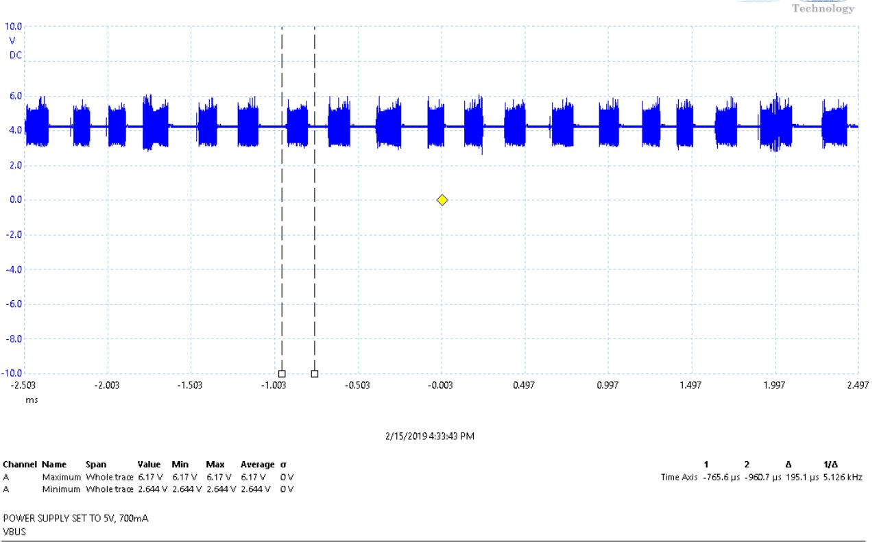

  • Hi Joel,
    I have connected a power supply in place of an USB adapter. However, I am unable to set the current limit to 1A on the power supply. Every time I increase the current limit past 700mA the voltage drops to 4.1V and then the input current decreases to 60-100mA & voltage resets to 6V. Essentially the power supply stops operating in CC mode and switches to CV mode. It seems like it is the VINDPM affecting the charging circuit and causing the current to be limited. If the input voltage is below 4.3V does the IC start to reduce the charging current? What can cause the input voltage to be pulled down to 4.1V?
    Thank You,
    Jobby
  • Hey Jobby,
    When the charger hits VINDPM, the charge current is reduced. On the BQ25606, the VINDPM threshold is the higher of wither 4.3V OR VBAT+300mV. It will reduce the charge current so much so that the input voltage is regulated to that threshold.
    VINDPM is there to protect your adapter from overloading when you do not have a fixed or known current limit.
    So I find it odd that the input current suddenly drops to 60-100mA when the current limit is increased past 700mA.

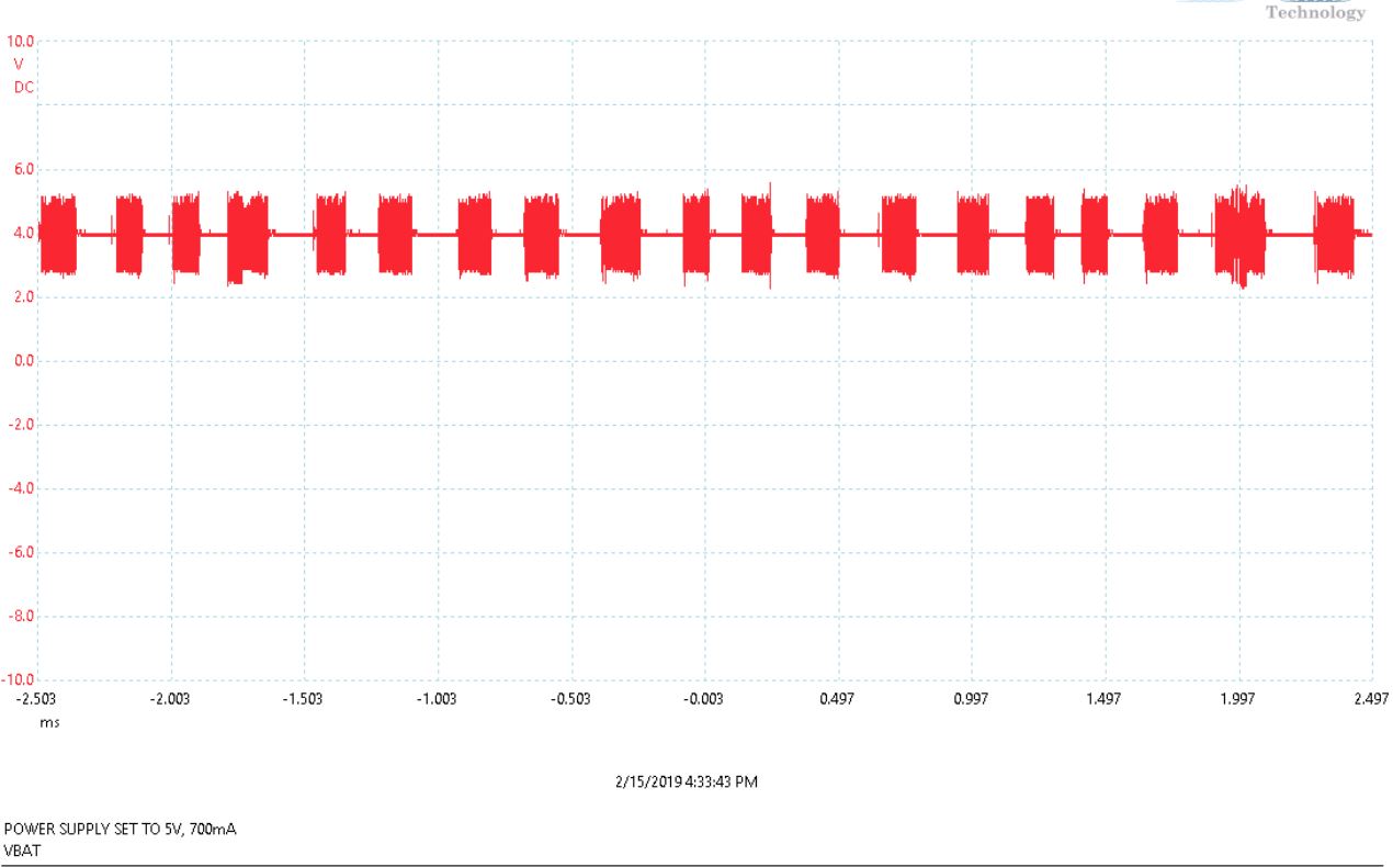

  • Hi Joel,
    Yes, the power supply is set to 5V DC source then set a constant current limit of 700mA. For the second instance the power supply is set to 5V DC and current limit is set above 750mA, however the voltage resets to 5V and the current fluctuates between 10mA-120mA until the current limit is reduced to below 700mA. I have attached the waveforms for the pins 5V DC and 700mA current.
    If the VBUS voltage falls below the VINDPM range does the charger automatically set the charge current to the termination current regulation? Does stat pin only enter LOW state once the V_BATT is equal to V_SYS_MIN (3.68V)?
    Jobby
  • Hey Jobby,
    The input voltage looks to be tracking with the battery voltage. We cannot see the oscillation due to the timescale. This would be valuable to see. However, from the moments of no oscillation, VBAT and VBUS are very close in value.
    In this case, the charger would have hit the SLEEP condition which disables the converter. When VBUS falls below the VINDPM range, the converter will stop providing power to the output and if deep enough the aforementioned SLEEP threshold, the converter and charging will be disabled.
    STAT pin is only LOW when charging. It will also oscillate at 1Hz when there is a fault present.
    Joel H
