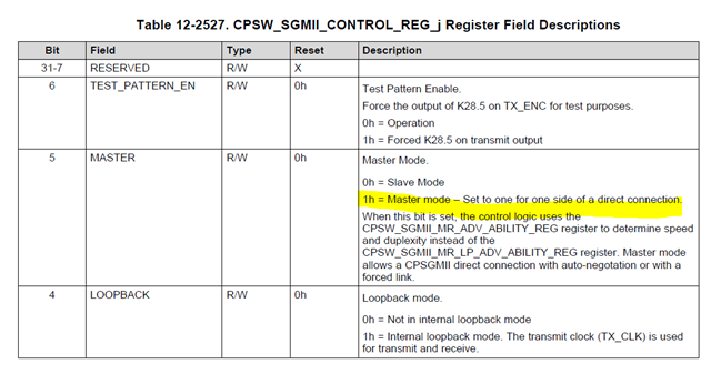

        my problem is sgmii3 and sgmii4 ,Can be configured to ENET_MAC_SGMIIMODE_SGMII_AUTONEG_MASTER at the same time?
    in sdk 7.3 rtos + linux if i configured the sgmii3 and sgmii4 to ENET_MAC_SGMIIMODE_SGMII_AUTONEG_MASTER  at the same time,
    ioctl has some error like next
    [MCU2_0] 73.818903 s: EnetMod_ioctl: cpsw9g.cpts: Failed to do IOCTL cmd 0x0101030c: -14
    [MCU2_0] 73.818946 s: EnetPer_ioctl: cpsw9g: Failed to do IOCTL cmd 0x0101030c: -14
    [MCU2_0] 73.818981 s: Enet_ioctl: cpsw9g: IOCTL 0x0101030c failed: -14
    [MCU2_0] 74.028823 s: CpswCpts_ioctl: Failed to lookup for event: -14
    but if i use one of sgmii it's no error
    I will double check but I don't think you can have both sides set to master, as per the TRM only one side must be master for a direct connection.

    Maybe my description is wrong. I mean that I need to use two sgmii's mac2mac mode. When I use sgmii4's mac2mac mode and configure it as master, then sgmii3 can't be used as the master mode of mac2mac. Is this right?
    When I set up using the following schematic , the ioctl has error like this
    I see what you mean, you cannot configure two SGMII Masters on the device at the same time.

  • Any port can be configured for SGMII based on the SOC SERDES mux registers.
    A SGMII can communicate between a master and slave in auto-negotiate, or both ends can be configured into master without SGMII.
    Auto-Negotiate mode:
    That is Device A  SGMII_Mr_Adv_Ability = 0x9801 and sgmii_Control = 0x0021 and Device B SGMII_Mr_Adv_Ability = 0x1 and sgmii_Control = 0x1 for auto-negotiate between Device A and Device B.
    Force Line mode:
    Or both sides could be SGMII_MR_ADV_ABILITY = 0x9801, and SGMII_CONTROL = 0x0020
    You should look at the WIZ_Px_ALIGN_RX_DELAY should be non-zero and steady. If Zero, something fundamental, lane not programmed, incorrect IP muxing, incorrect PLL reference clock. If it is changing, check wiz_standard_mode should be zero, there was a boot issue that set standard_mode to 3 which miss-programs the SERDES for SGMII.
    If it links, but there are CRC errors, it could be that the SERDES differential pins are swapped, there is a polarity flip in the program interface, but there was an error in the code that prevented it from staying that way. Make sure you have the latest SDK.
