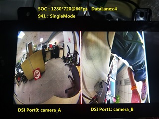

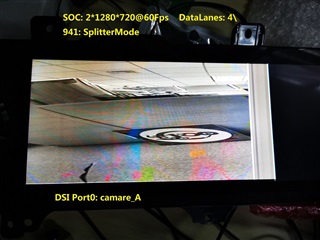

    And here is a good news, I use a set of parameters from another post to try to display 1280*800 DSI on my screen.And it works!
    (Here is the link of the post: https://e2e.ti.com/support/processors-group/processors/f/processors-forum/1015474/tda4vm-how-to-set-dsi-dphy-div-for-2560x800-resulution/3755063?tisearch=e2e-quicksearch&keymatch=TDA4%20DSI#3755063)
    But When I change the resolution to 1920*720 in SOC & 941 and replace the orignal parameters of  DPHY with you provide before. It still can't show anything.So I start to doubt whether my DPHY parameters are correct:

  • Hi Brijesh,
    Thank you for providing such detailed help.
    I have successfully tested many kinds of resolution to display on the screen. They have a common premise that 941 works in Single Mode.
    Now I'm tring to achive my ultimate goal: Dual-Screen display, which needs 941 work to work in Splitter Moed to crop and output the SupperFrame to two DSI port..
    There are two problems when the video isdisplayed on the screen:
    1.The video image is black and white instead of color
    2.The cropped image area is inconsistent with the configuration in the code.
    Here are my code and pictures of test result:
    1.Resolution, Pixel Clock, HS/VS:
    prm.timings.width = 2*800U;
    prm.timings.height = 600U;
    prm.timings.hFrontPorch = 2*40U;
    prm.timings.hBackPorch = 2*88U;
    prm.timings.hSyncLen = 2*128U;
    prm.timings.vFrontPorch = 1U;
    prm.timings.vBackPorch = 23U;
    prm.timings.vSyncLen = 4U;
    prm.timings.pixelClock = 2*40000000ULL;
    2.Dphy params:
    /* params for 2560*720 */
    dsiObj->dphyTxIpDiv = 0x2;
    dsiObj->dphyTxOpDiv = 0x2;
    dsiObj->dphyTxFbDiv = 0x173;
    dsiObj->dphyTxRate = (0x0E<<0)|(0x0E<<5);//(0x7<<0)|(0x7<<5);
    dsiObj->cfgDsiTx.numOfLanes = 0x2u;
    dsiObj->privDsiTx.numOfLanes = 0x2u;
    3.Pictures of resulat:
    Is there any additional configuration that needs to be done when I want to output a supper frame? What's your opinion on this problem?
    Damon

  • Hi Brijesh,
    I inadvertently solved the problem about 941 working in SplitterMode.It is related to the width & height settings of the output image of the SRV node I set:
    Background, the graph of my demo is:capture -> convert -> srv -> convert -> display
    1.At first, I set the width & height to 2560*720. The image displyed on the screen will be abnormal.
    2.When I set it to  1920*720 or 1280*720 and hold the width & height of display image to  2560*720. The screen is displayed normally.
    Although the problem has been resolved, the specific reason is not clear yet.
    I checked the relevant code of the SRV node,but still don't understand why the SRV node cannot be set to 2560*720 ? How do you think about this?
    Damon

  • Hi Brijesh,
    Yes, I;m able to get dual serialized output from ub941 with1280x720 resolution.
    My goal is to display 1280*720 video images on both screens. So I think the SOC should output a super frame of 2560*720.
    Then I thought the width & height of output images of each node in my demo should also be 2560x720 at first.
    Now I just changed the output image of SRV node from 2560x720 to 1280*720. And it displayed normally on two DSI output port.
    To be honest, I'm not so sure about the width and height of the output image of these two nodes.So I want ot hear your suggestions.
    Damon

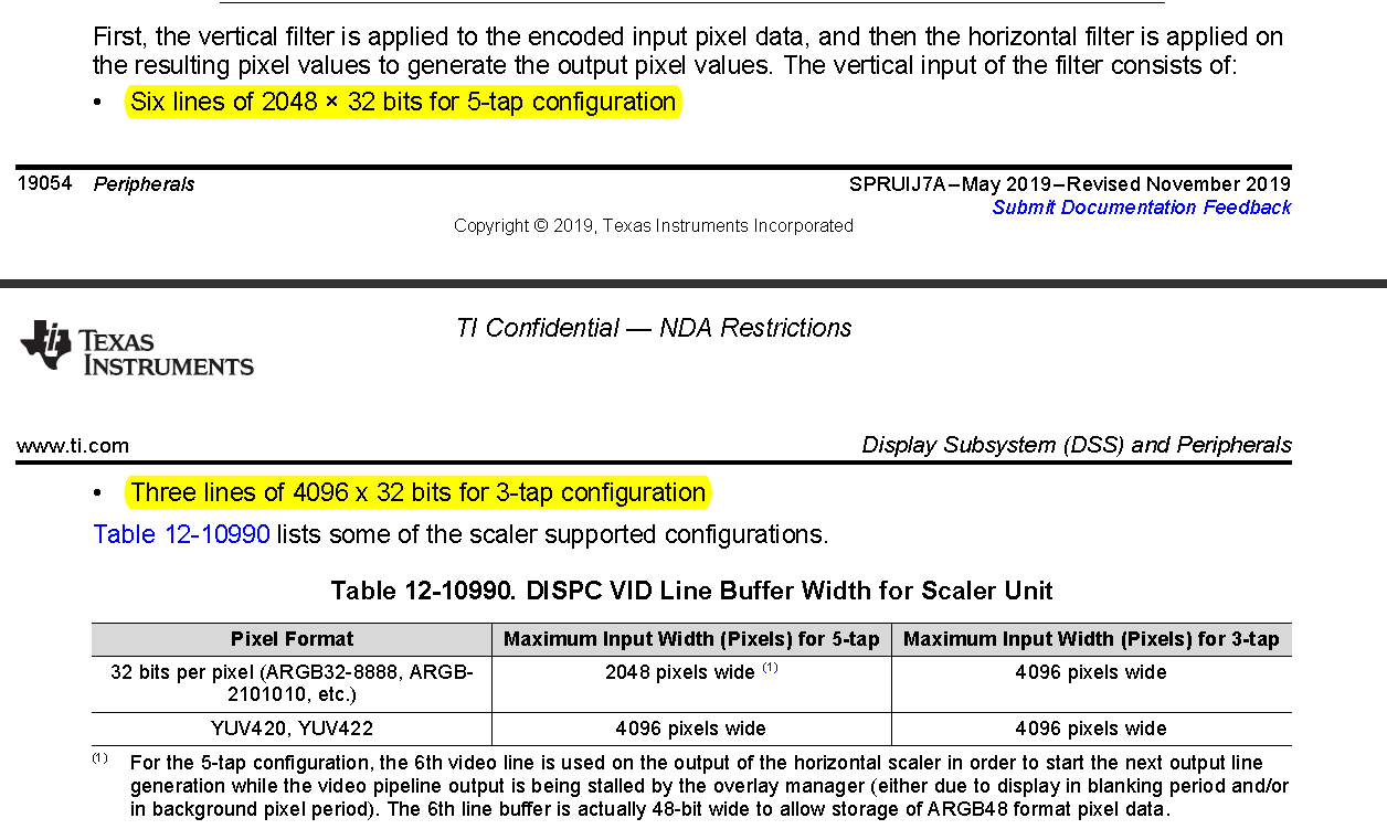

  • Hi Brijesh,
    From the TRM manual I learned that the Scaler Unit in DISPC_VID  moudle supports YUV420 format input image with a maximum width of 4096 pixels. As shown below:
    So my guess may be wrong! But I can't figure out it. What's do you think?
    1. When the input image is YUV format, Display doesn't support larger resolutions.
    Damon
  • Hi Damon,
    Sorry for the late reply.
    I this this is limitation due to 5-tap filter. can try changing to 3-tap filter and see if it works fine for NV12 format?
    Brijesh

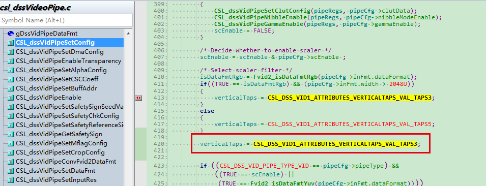

  • Hi Brijesh,
    I don't get it.
    According to the document description, I only saw the limitations of 3-taps and 5-taps on the NV12 format. How does it affect the NV12 format?
    I found only one palce to configure the filter:
        File: psdk_rtos_j7\pdk_jacinto_07_03_00_29\packages\ti\csl\src\ip\dss\V4\priv\csl_dssVideoPipe.c.
        API: CSL_dssVidPipeSetConfig()
    Can you please tell me the specific operation to modify the 3-taps filter?
    Damon
  • Hi Damon,
    I totally agree that for NV12/yuv422 format, the line limit is 4096 for both 5-tap and 3-tap filter. But for other formats, there is different of line limit for 5-tap filter and 3-tap filter. 3-tap filter provides more line width, so wanted to just try it out.
    Unfortunately, there is no driver interface to set the vertical taps, you would have to directly update registers to change this settings.
    Brijesh

  • Hi Brijesh,
    I made changes in the API: CSL_dssVidPipeSetConfig() of csl_dssVideoPipe.c file.
    I added a line to set the filter mode.
    Test1: I set the input image format to be RGBA and size to be 2560*720.Tested the 5-taps and 3-taps modes separately.And didn't find any difference.
    Test2: I set the input image format to be NV12 and size to be 2560*720. Tested the 5-taps and 3-taps. And didn't find any difference too.
    Do you have time to reproduce this issue and trace the cause?
