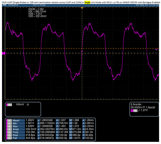

SK-AM62P-LP: LVDS single link with DSS managed by WKUP_R5FSS0
I need to manage a single link LVDS display (4 lanes + clock) from the wakeup R5.
The issue is that when switching to single link (from the syscfg), the LVDS common mode voltage drops to 0.6V
Changing under "OLDI configration" the "Dual Mode" to enable, the LVDS common mode voltage is (as expected) 1.2V.
We have found the issue. It turns our the MCU+ DSS driver for OLDI bridge was missing to enable the 1.2V IO bandgap reference for the OLDI single link mapper configuration. After enabling this, I am now able to see Vocm of ~1.2V. A patch will be provided shortly by Divyansh for you to try on your end.
OLDI CLKP (Single-Ended w/ 100-ohm termination resistor across CLKP and CLKN) in Single Link Mode with MCU+ w/ R5 on AM62P SKEVM with Bandgap Enabled:

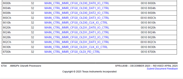

Hi Board designers,
Refer AM62P for OLDI MMR register description.

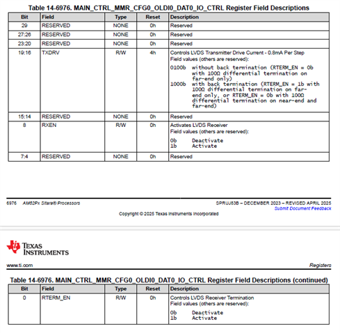

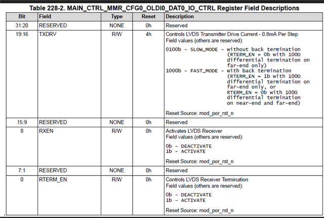

The OLDI peripheral supports configuring drive strength. Please refer below data sheet section
6.11.5.18 OLDI
6.11.5.18.1 OLDI0 Switching Characteristics
Table 6-103 and Figure 6-87 present switching characteristics for OLDI0.
Table 6-103. OLDI0 Switching Characteristics
(1) Slow mode: TXDRV[3:0] = 0100b without back termination (RTERM_EN = 0b with 100Ω differential termination on far-end only)
(2) Fast mode: TXDRV[3:0] = 1000b with back termination (RTERM_EN = 1b with 100Ω differential termination on far-end only, or
RTERM_EN = 0b with 100Ω differential termination on near-end and far-end)
I can see the registers for AM62x.
AM62P
Please refer to the TRM update captured as picture.

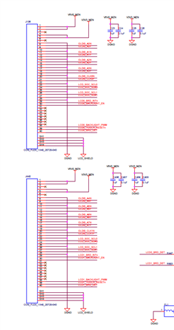

Hi Board designers,
OLDI interface connections for Single link and dual link
x1 single link
X1 single link
Dual link
