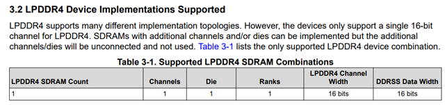

  • Hi Expert
    (1) AM6412 memory controller has CS0/CS1 two Chip select, we want to know whether the design of LPDDR4 x16 memory down supports dual rank application?

  • (1) AM6412 memory controller has CS0/CS1 two Chip select, we want to know whether the design of LPDDR4 x16 memory down supports dual rank application?
    (3) How to set enabled in the LPDDR4 on-die termination software?
