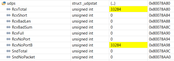

  • I was talking to our NDK expert regarding your issue. Here is the expert's suggestion:
    "Can you ask them to check the NDK’s statistics? The stats are globals in the NDK, called "tcps", "udps", "ips" and “icmps”. You can see details in this thread on how to check, along with a screen shot."
    e2e.ti.com/.../1776221
    This would provide us more information to debug the issue.
    Vikram
  • I'm running some tests, and I discovered that NDK stops responding after at least ten minutes of inactivity.
    After that, it takes one to three minutes to switch back to normal operation.
    The only action required is to ping NDK until it recovers and starts responding to incoming ICMP messages. The ping rate is at least one ping every 30 seconds, or so.
    This happens both under Windows and Linux clients.
    Is this information useful?

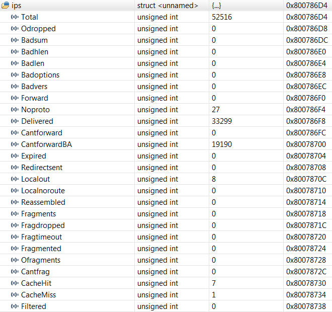

    Here is the response from our NDK expert:
    Can you ask them to list all of the tasks running in their system, as well as the priorities of each?
    Do they have a simple test case that they can share that reproduces the problem?  Preferably this should be for the Am3359 (i.e. NOT their custom hardware).
    Also, this begs another question – do they see this issue on the AM3359 EVM?  Or does it only happen on their custom h/w?
    For stack debug:
    The point at which all Ethernet frames enter the stack is at NIMUReceivePacket (ti/ndk/stack/nimu/nimu.c).  It may be better to check for any expected packets in this function, instead of IPRxPacket().
     Regarding the stats they shared:
                    I see one stat in particular that stands out:
             UINT32  CantforwardBA;  /* packets rcvd with illegal addressing */
                    In the screen shot, it’s been incremented to 19,190 – that seems pretty high to me.
                     This stat provides us with a couple of hints, based on the code that increments it.  It’s incremented in 2 places in ipin.c:
                 *  If IPDst is a multicast address, check extra
                 *  for perfect filtering:
                 *  - 224.0.0.1 is always allowed.
                 *  - If host is not joined, the others are filtered out.
                if (IN_MULTICAST(IPDst) && IPDst != HNC32(0xe0000001) &&
                    !IGMPTestGroup(IPDst, IFGetIndex(hIFRx))) {
                    /* Discard the packet, and update the counter */
                    ips.CantforwardBA++;
                    PBM_free( pPkt );
                    return;
                   (Multicast packets received but this host is not part of the group)
                    And here:
        /* If we get here, the packet is not for us */
        /* Verify Packet can be forwarded */
        /* We can not foward ... */
        /*    - if the packet was rx'd on a local IF AND we're not source */
        /*      routing (this is loop caused by a bad route configuration) */
        /*    - if forwarding disabled */
        /*    - if addressed to an experimental, multicast, or loopback IP */
        /*    - if mac addr received on was broadcast */
        if( (!hIFRx && !SrcRoute) || !IP_FORWARDING ||
            IPDst == INADDR_ANY || IPDst == INADDR_BROADCAST ||
            IN_EXPERIMENTAL(IPDst) || IN_MULTICAST(IPDst) ||
            IN_LOOPBACK(IPDst) || (pPkt->Flags & FLG_PKT_MACBCAST) )
            PBM_free( pPkt );
            return;
    Both issues look to be related to multicast, or if not, to IP forwarding or a problem with the route table (case immediately above).
    Are they using multicast in their app?  Or does the above code ring a bell for them?
    Have they configured the EMAC driver to accept multicast packets?  If they aren’t using (or needing) multi cast, it could be that they are being overwhelmed by multicast traffic.
    In any case, based on that statistic, they are seeing a lot of drops due to one or both of these checks in the code shown above.
    Let us know if this helps.
    Vikram

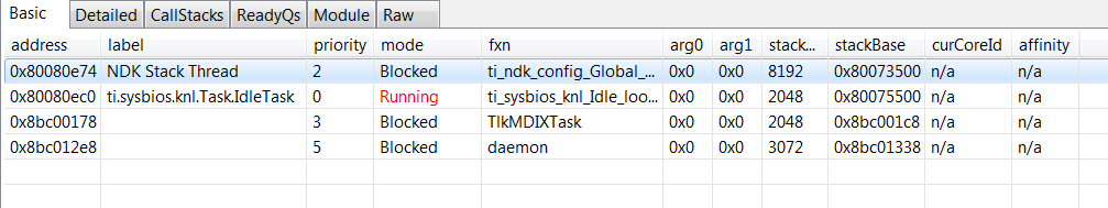

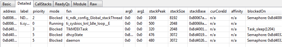

  • This is task summary in ROV:
    HWI summary:
    Our custom hardware's ethernet section is identical to AM335X EVM board, with two differences:

    I've already seen the "CantforwardBA" stats, but there is nothing I can do about: there is no custom code binded to NDK stack. Only stock ICMP handshake and telnet console example code. If "strange" packets are fed into NDK, they are from network traffic only.
    When NDK hangs, most of times NIMUReceivePacket is not called at all (so, no packets are processed by stack), but sometimes NIMUReceivePacket is called but no response is sent back to host PC. Same happens for RX HWI.

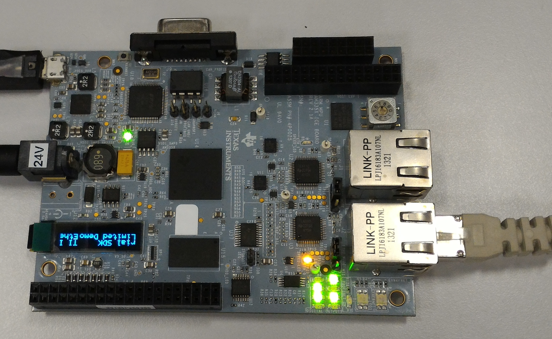

  • And here is a pic of our board setup:
    1-2 shorted on J18 and J19. The ethernet cable connected to J2.
    Vikram

    I see that in your board the orange "SPEED LED" is off: maybe you have some issues negotiating the connection speed; I can't help, I don't know the os_drivers library details, nor the NDK stack details.
    In project I have included "ndk_test.ccxml" target configuration. Are you connecting to the target with this config?
    Are you running the application after CPU is initialized by GEL file?
    You should see the error "timer frequency mismatch" when cpu tries to jump to main() function; this is a known issue: I've found lots of E2E forum topics about that error. With my custom board gel file this does not occur, so there must be troubles in TMDXICE3359_v2_1A.gel file. You can skip this issue, it's not the topic of the discussion and is not causing troubles to me.

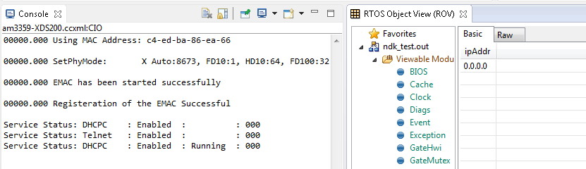

  • I spent some time trying to run your example but I had no luck. The app hung during DHCP as I had mentioned in previous post:
    Here is output from the console:
    [CortxA8] 00000.000 Using MAC Address: c4-ed-ba-86-ea-66
    00000.000 SetPhyMode:       X Auto:8673, FD10:1, HD10:64, FD100:32, HD100:256, FD1000:128 LPBK:8192
    00000.000 EMAC has been started successfully
    00000.000 Registeration of the EMAC Successful
    Service Status: DHCPC    : Enabled  :          : 000
    Service Status: Telnet   : Enabled  :          : 000
    Service Status: DHCPC    : Enabled  : Running  : 000
    00000.300 cpsw_MDIO_FindingState: PhyNum: 1
    00000.400 Enable Phy to negotiate external connection
    00000.400 NWAY Advertising:
    00000.400 FullDuplex-1000
    00000.400 HalfDuplex-100
    00000.400
    Service Status: DHCPC    : Enabled  : Fault    : 002
    Then I spoke to our network expert and he sent a simple built app and gel file. I was able to run the app successfully though I had to short pins 2 and 3 on J18 and J19. I ran this app and after about 20 minutes I tested by pinging. The pings were successful, no packets were lost. The board was connected to our office network which has very high network traffic to emulate your set-up.

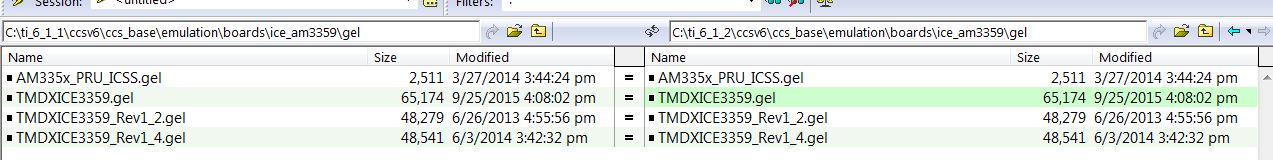

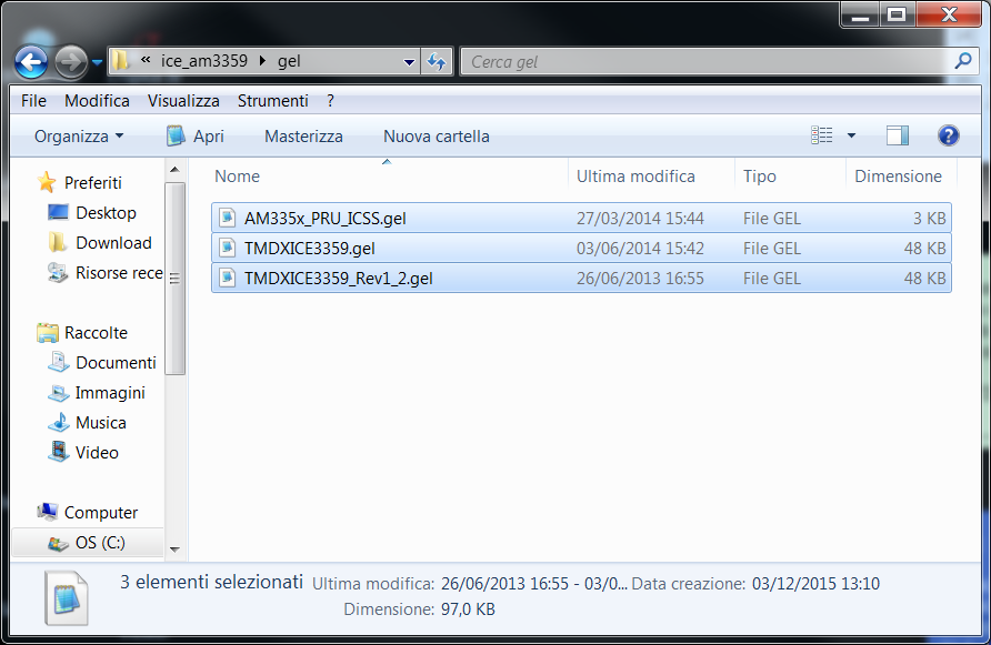

  • Hi Vikram. I've:
    1. downloaded the processor SDK
    2. followed this guide
    3. imported NIMU_BasicExample_icev2AM335x_armExampleproject in CCSv6
    4. double clicked .cfg file to set my favourite IP address
    5. succesfully built the project
    6. downloaded to ICEv2 after executing TMDXICE3359_v2_1A_TI.gel INIT command.

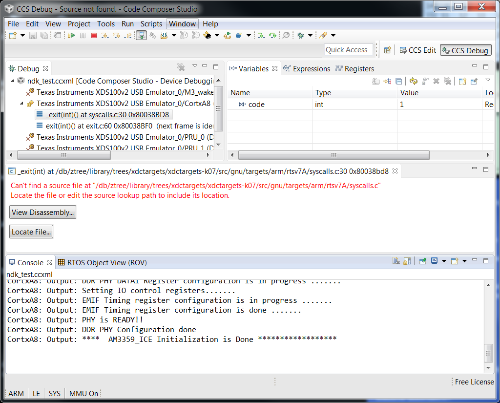

    I need to retry several times to get the application jump to main():

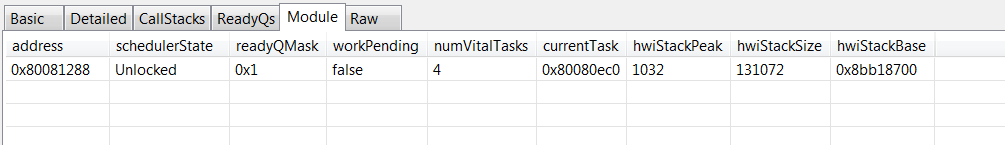

    When (with a robust dose of serendipity) application starts, this is CCS console output (seems fine):
    but the application does not responds to ping commands, and on serial console I get this:
    In ROV there is no evidence of HWI (?):
    This is task summary tab:
    The link speed led on ICEv2 flashes randomly, and the same are doing the leds on switch's port where the ethernet cable is connected to.

  • I tried today and have no issue to run the NIMU example, here is the details:
    1. HW card: AM335x ICEv2 card
    2. CCS 6.1.2, JTAG: Texas Instruments xds100v2 USB Probe
    3. When create the target connection, the Device is ICE_AM3359, so a GEL file ..\..\emulation\boards\ice_am3359\gel\TMDXICE3359.gel is automatically added to cortex A8
    4. When you connect the A8 core, the following is seen:
    CortxA8: Output: ****  AM3359_ICE Initialization is in progress ..........
    CortxA8: Output: ****  AM335x ALL PLL Config for OPP == OPP100 is in progress .........
    CortxA8: Output: Input Clock Read from SYSBOOT[15:14]:  24MHz

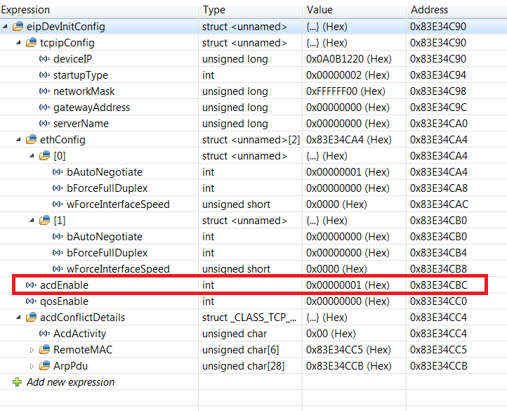

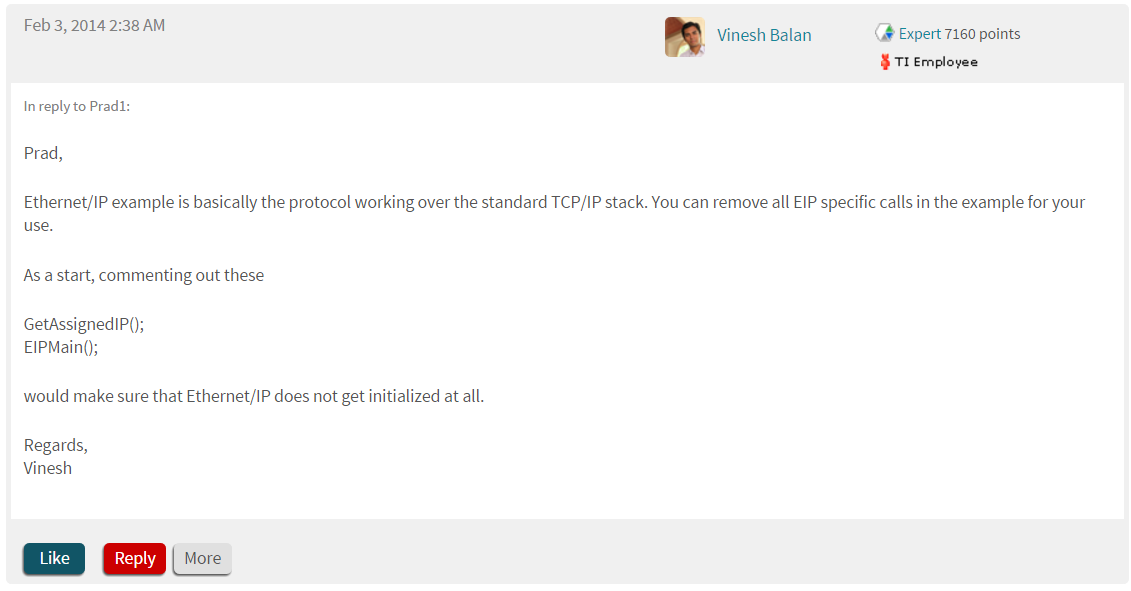

    Fixed this, I've followed the Vinesh's suggestion to try EthernetIP demo application: EthernetIP protocol stacks over NDK's TCP/IP, so commenting out EthernetIP stuff will result in a plain TCP/IP sample application:
    Everything works fine: the problem does not occur.
    So, following the code, I started to cut out all the EthernetIP related code and configs. No issues, until I set eipDevInitConfig.acdEnable=FALSE. This should disable some ethernetIP specific code (mind that EthernetIP main task in commented, so no EthernetIP stuff is actually running):
    With this flag set to 0 the issues comes ou!
    So it must be something related to CPSW driver/NDK initialization that is skipped when that flag is set to FALSE.

  • Today update:
    - when eipDevInitConfig.acdEnable=FALSE and USE_CPSW_DRIVER is defined, NDK will hang in about 10 minutes.
    - when eipDevInitConfig.acdEnable=FALSE and USE_CPSW_DRIVER is NOT defined, NDK will be fine forever.
    So, NDK running through ICSS is fine, regardless of the acdEnable switch.
    This should restrict the investigation to some CPSW initialization code, somewhere in NIMU drivers.

  • HI Eugenio,
    eipDevInitConfig.acdEnable is used by Ethernet/IP application to enable and disable ACD (Address Conflict detection). Once you use it as switch, this should not impact your application.
    I removed the EIP dependencies from the application, enable USE_CPSW_DRIVER and tested. The application worked for 12- 16 hours and during these time i was using five instances of fping to ping the application.  I have attached the modified application. Can you please test at your side.

  • Hi Eric, I've find that the problem in these steps is at point 3) of HW side.
    This gel file ..\..\emulation\boards\ice_am3359\gel\TMDXICE3359.gel does not fit ICE board rev 2.
    ICEv2 has DDR3 ram, and that gel file sets the DDR controller for DDR2 (stuffed in previous ICE board).
    ICEv2 comes with its own gel file: \ti\am335x_sysbios_ind_sdk_1.1.0.10\sdk\tools\gel\ICETMDXICE3359_v2_1A.gel
    How can you test the NIMU_BasicExample_icev2AM335x_armExampleproject with the wrong gel file?

  • Hi Eric.
    I've said that because the TMCDICE3359.GEL that comes with CCSv6 has this AM3359_ICE_Initialization() routine:
    //****************************************************************************** //System Initialization //****************************************************************************** menuitem "AM335x System Initialization" hotmenu AM3359_ICE_Initialization() { GEL_TextOut("**** AM3359_ICE Initialization is in progress .......... \n","Output",1,1,1); ARM_OPP100_Config(); DDR2_EMIF_Config(); GEL_TextOut("**** AM3359_ICE Initialization is Done ****************** \n\n\n","Output",1,1,1); }
    This is the content of C:\ti\ccsv6\ccs_base\emulation\boards\ice_am3359\gel folder:
    Attached you can see the TMDXICE3359.gel file we're discussing about:
    TMDXICE3359.zip

  • Hi Eric, I thought I was clear: the file I've posted here in forum comes from the same path you suggested: C:\ti\ccsv6\ccs_base\emulation\boards\ice_am3359\gel\TMDXICE3359.GEL
    I'm so sorry, but this file come straight from the Code composer studio installation (six month ago, rev 6.1.1). Please, take a deeper look at my yesterday's post: you will see a screenshot of the gel files in the folder you specified.
    In C:\ti\am335x_sysbios_ind_sdk_1.1.0.10\sdk\tools\gel\ICE (Industrial SDK, the software pack that should be used to test ICE board) I can find two gel files:
    TMDXICE3359_v2_1A.GEL

  • Hello Eugenio ,
    I am Prajith's colleague and I saw this post today. First of all, I went through all discussions in this thread and was interested to reproduce the issue in our setup. But I could not see the issue in our environment!
    Below are the summary of steps I did:
    1. Downloaded the application which you have shared
    2. Used the the SD card binary (Debug\ethernetip_adapter_SD.bin) after renaming it to 'app'. I had SD card bootloader for AM335x ICEv2.1 already
    3. In the ICEv2.1 board, Jumper settings are made for CPSW mode and booted the board with SD card.
    4. In the UART console, startup messages displayed, but it didn't display the application IP address. When I connected the board to test PC and opened wireshark, I could see DHCP discover messages coming the ICEv2.1 board
    5. Using a DHCP server running in the test machine, I have assigned an IP address successfully to DUT, now I can ping the board from the test PC and ICMP response frames are seen wireshark
    6. As per your comment, The problem occurs when the board is connected to a network and no requests are done to its ip address for a certain amount of time. After about 450 seconds, the application will not reply to ping requests.', I have connected network packet generator (Its a hardware which we use for stress tests which can send around 148000 frames per second) to both ports of ICEv2 board and pumped a storm of Broadcast frames simultaneously.
    7. This setup is maintained for around 8 minutes. There is no ping requests to application during this time
    8. Removed the cables from packet generator and connected the test machine again to DUT
    9. Issued ping requests from cmd and I can see responses from the application (confirmed with wireshark)
    Can you please let us know what we are missing here compared to your test environment/procedure?
