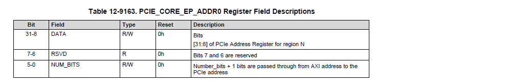

1. I cannot found the register description of PCIE_CORE_RP_ADDR0 (0x0D400000), the TRM only has  PCIE_CORE_EP_ADDR0 register description.
I referred J721E_DRA829/TDA4VM/AM752x_SR1.0_TRM. Can you tell me how to use PCIE_CORE_RP_ADDR0?

     At address 0x0D400000 resides the PCIE_CORE_ATU_WRAPPER_OB_0_ADDR0 register which contains bits 31:8 of the PCIe address and the number of AXI address bits passed through for outbound region 0.
    The PCIE supports 32 outbound address translation regions.

  • Hi Stan,
    Thanks for you quick reply.
    I have only J721E_DRA829_TDA4VM_AM752x_SR1.0_NDA_TRM_vInitial.pdf.
    You wrote:
    "At address 0x0D400000 resides the PCIE_CORE_ATU_WRAPPER_OB_0_ADDR0 register which contains bits 31:8 of the PCIe address and the number of AXI address bits passed through for outbound region 0."
    It seems to be the same with EP description not RC.

    That particular information in the SDK is currently missing from the TRM but will be added in a future revision.
    So, looking again at the register at address 0x0D400000 (that is, the ADDR0 register for Outbound Region 0):
    Bits [27-20] of field [31-8] DATA define the Bus Number.
    Bits [19-12] of field [31-8] DATA define the Function Number.
    These form the Completer ID information for a configuration TLP.
    When the Completer ID is conveyed through the Outbound AXI to PCIe Address Translation Registers, the [5-0] NUM_BITS field should be programmed to 6'd11.
