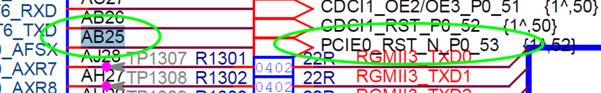

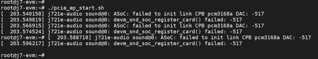

CCS/TDA4VM: Questions about using PCIe on tda4
Part Number: TDA4VM
  I'm using TDA4 custom board.But when the kernel starts, it is found that the kernel does not print the message related to the PCIe

  • We connected it to the pin AB25 of TDA4.
    We connect two custom board, one is RC, the other is EP.
    First on th EP, we execute the command with using shell script:
    mkdir /sys/kernel/config/pci_ep/functions/pci_epf_test/func1 -p
    echo 0x104c > /sys/kernel/config/pci_ep/functions/pci_epf_test/func1/vendorid
    echo 0xb00d > /sys/kernel/config/pci_ep/functions/pci_epf_test/func1/deviceid
    echo 2 > /sys/kernel/config/pci_ep/functions/pci_epf_test/func1/msi_interrupts
    echo 2 > /sys/kernel/config/pci_ep/functions/pci_epf_test/func1/msix_interrupts
    ln -s /sys/kernel/config/pci_ep/functions/pci_epf_test/func1 /sys/kernel/config/pci_ep/controllers/2900000.pcie-ep/
    mkdir /sys/kernel/config/pci_ep/functions/pci_epf_test/func2
    echo 0x104c > /sys/kernel/config/pci_ep/functions/pci_epf_test/func2/vendorid
    echo 0xb00d > /sys/kernel/config/pci_ep/functions/pci_epf_test/func2/deviceid
    echo 2 > /sys/kernel/config/pci_ep/functions/pci_epf_test/func2/msi_interrupts
    echo 2 > /sys/kernel/config/pci_ep/functions/pci_epf_test/func2/msix_interrupts
    ln -s /sys/kernel/config/pci_ep/functions/pci_epf_test/func2 /sys/kernel/config/pci_ep/controllers/2900000.pcie-ep/
    mkdir /sys/kernel/config/pci_ep/functions/pci_epf_test/func3
    echo 0x104c > /sys/kernel/config/pci_ep/functions/pci_epf_test/func3/vendorid
    echo 0xb00d > /sys/kernel/config/pci_ep/functions/pci_epf_test/func3/deviceid
    echo 2 > /sys/kernel/config/pci_ep/functions/pci_epf_test/func3/msi_interrupts
    echo 2 > /sys/kernel/config/pci_ep/functions/pci_epf_test/func3/msix_interrupts
    ln -s /sys/kernel/config/pci_ep/functions/pci_epf_test/func3 /sys/kernel/config/pci_ep/controllers/2900000.pcie-ep/
    echo 1 > /sys/kernel/config/pci_ep/controllers/2900000.pcie-ep/start
    After that,we power on th RC.But after the kernel starts, it fails. Print as follows::

    could you confirm if the RC can boot without crash, if you don't execute the EP scripts?
    from where the kernel crashes, it appears to be that RC tried to configure EP's, and it run into incorrect address space. You mentioned this is a pair of customer hardware. if so, could you confirm:
    1. can the RC boot with a standard PCIe card, see an SSD or something known?
    2. what memory regions does EP expose to PCIe space?
    Jian
  • could you confirm if the RC can boot without crash, if you don't execute the EP scripts?
    If I don't execute the EP scripts, the RC can boot without crash.
    I am sorry that I do not have any standard PCIe card.
    My SSD connect the PCIE2 of the TDA4,but the RC can not see the SSD with the lspci command.
    The RC can only see the host bridge.
    I haven't changed any code other than the reset-gpio you mentioned earlier and setting EP mode. So it should be the default using the sdk7.1 according to the example:
    https://software-dl.ti.com/jacinto7/esd/processor-sdk-linux-jacinto7/latest/exports/docs/linux/Foundational_Components/Kernel/Kernel_Drivers/PCIe/PCIe_End_Point.html
    But this instruction has the following differences after execution on EP
