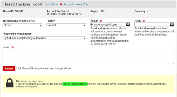

  • Hello Kanchuka,
    I would go to this thread and click "Ask a related question" for any of your questions regarding TIDA-00777 and TIDA-01063.
    I hope this helps,
    Joe
