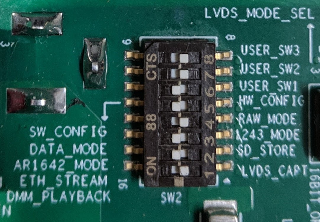

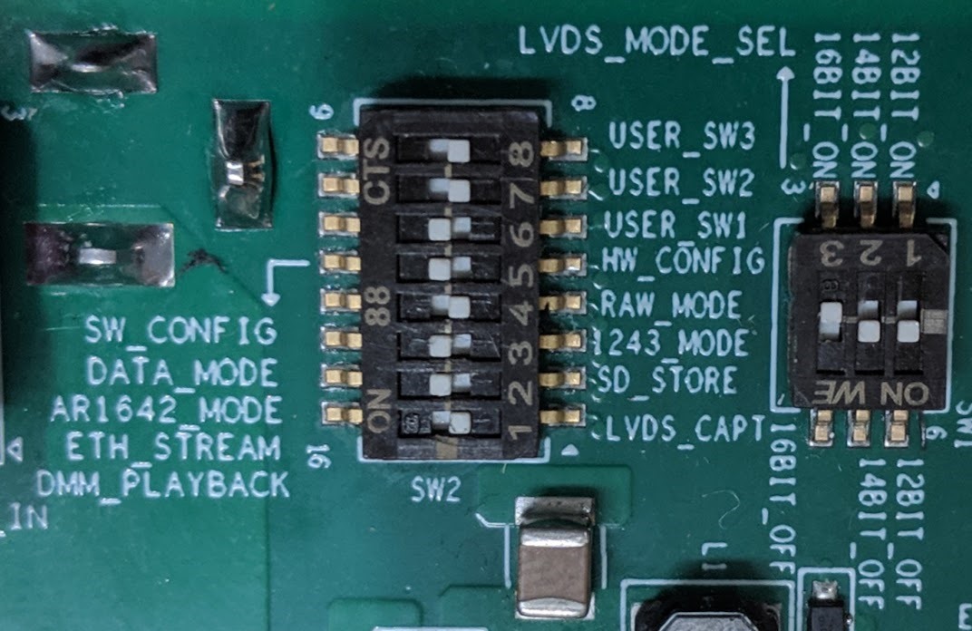

Okay, so this question has been frequently asked on this forum but none of the posts contained anything that worked for me.
I have an ES1.0 AWR1642BOOST that I am using with a DCA1000 board (latest version). I am following the online video as well as the quick start guide. I have both mmWave studio version 1.0 and version 2.0 and I have followed all the steps on both the versions of mmWave studio (mmWave studio 1.0 has the files for ES1.0 board). However, as soon as I press SPI Connect, nothing happens and the program is stuck there. I cannot use any other button or commands. Please help.
Akash,
What are your SOP settings on the EVM?
Make sure the SEMTEC is securely connected.
Using Uniflash please erase sflash on the EVM and try again (LINK).
Alex
Akash,
Look at the image below, bottom right for the label "SOP controls"
Please look at 1642 Users Guide located HERE on section 2.7, page 18.
Also look at the mmWave video 2.4 DCA1000 Training Video; it goes over SOP settings around 1:40 of the video
