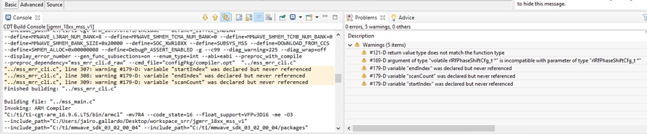

Hi, when I rebuild the DSS project I get this warnings:
and when I rebuild the MSS project I get this warnings:
are these warnings expected or am I doing something wrong?
Hello Jairo,
Those warning won't affect the application's functionalities.
Please refer to this old thread on a similar topic-
https://e2e.ti.com/support/sensors/f/1023/p/638908/2367288#2367288
Jitendra
