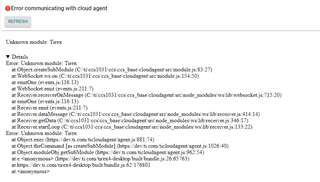

Hi Experts,
My customer installed the latest CCS(Version: 10.3.1.00003), and they are trying to connect Resource Explorer on CCS (View-->"Resource Explorer". However, it seems they had a connection failure. I introduced the following URL, although customer tried to do this troubleshooting, this issue was not resolved.
https://software-dl.ti.com/ccs/esd/documents/users_guide/ccs_troubleshooting.html#resource-explorer
Can I have your Expert's advice/comments on this, please?

    Can the customer provide:
    1) The exact error they see in Resource Explorer. A screenshot will be the best way to share thus.
    2) Host OS (and version) of the PC running CCS
    3) Diagnostic Logs. Specifically the Eclipse Error log (found in <WORKSPACE>/.metadata/.log) and JxBrowser logs.
    Thank you.
  • Was it this? Got this after updating resource explorer core (tirex) to 4.8.0. Currently using offline and connecting to cloud manually.
    I have tried restarting my pc, CCS and clearing .metadata and Cache under .jxbrowser-data. It happens across all the workspaces I have.
    OS- Windows 10 - 64 bit

  • An update. This doesnt make sense but I updated my TI compiler to the latest and restarted to apply the update. The tirex installation also appeared even though I did not choose to do so. It fixed the problem.
  • Hello Ki,
    It seems our customer was also able to fix this issue.
    I'd like to close this ticket. if I'll receive further issue, I'll submit new thread.
