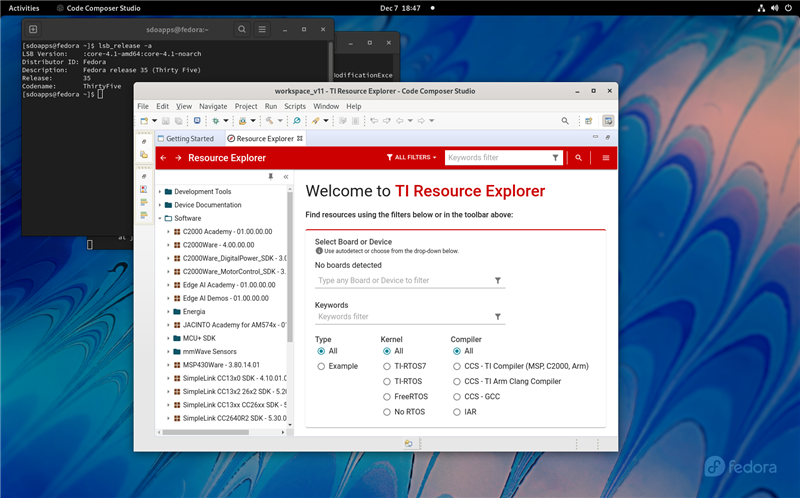

I set up a Fedora 35 environment with CCS11. I was able to reproduce the issue.
I was able to workaround the issue by opening a terminal and changing directory to: <CCS11 INSTALL DIR>/ccs/eclipse
The run the below commands:
> export GDK_BACKEND=x11
> ./ccstudio
This launched CCS and Resource Explorer seemed to work fine:
See if this works for you
