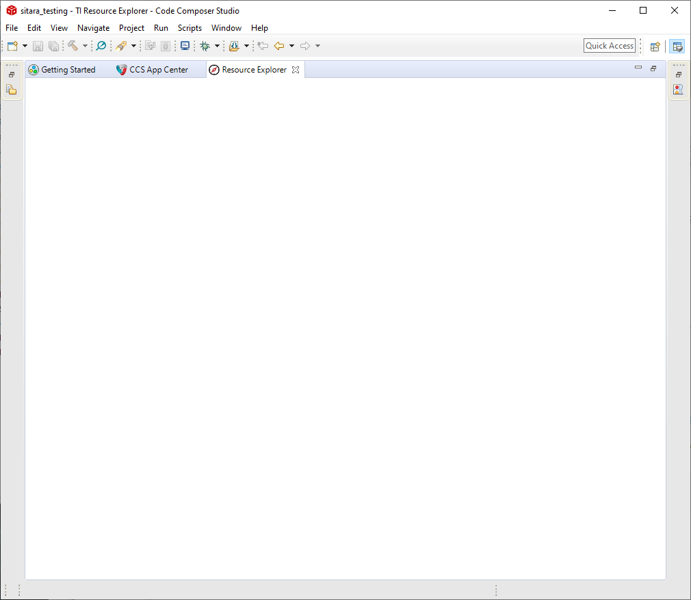

  Blank tab.  Hmm, OK.  So I look at the troubleshooting guide.  The suggestions are:

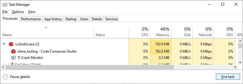

5) I closed the "Resource Explorer" and "Getting Started" tabs, so I just had a blank IDE.  Task Manager shows me this:
I then select "View / Resource Explorer" from the main menu, and I get a blank tab.  Task Manager now shows this:

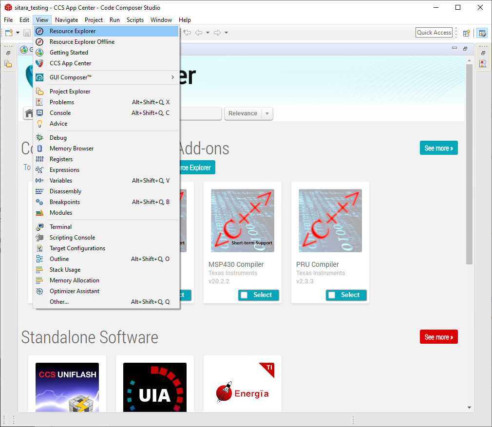

  • FYI, running Code Composer Studio version 9.3.0.00012.
    Getting Started looks fine.
    App Center looks fine.
    However, whether I open the Resource Explorer from the Getting Started screen or open it from the menu like this...
    ... I always wind up with a blank Resource Explorer tab.
    David R.
