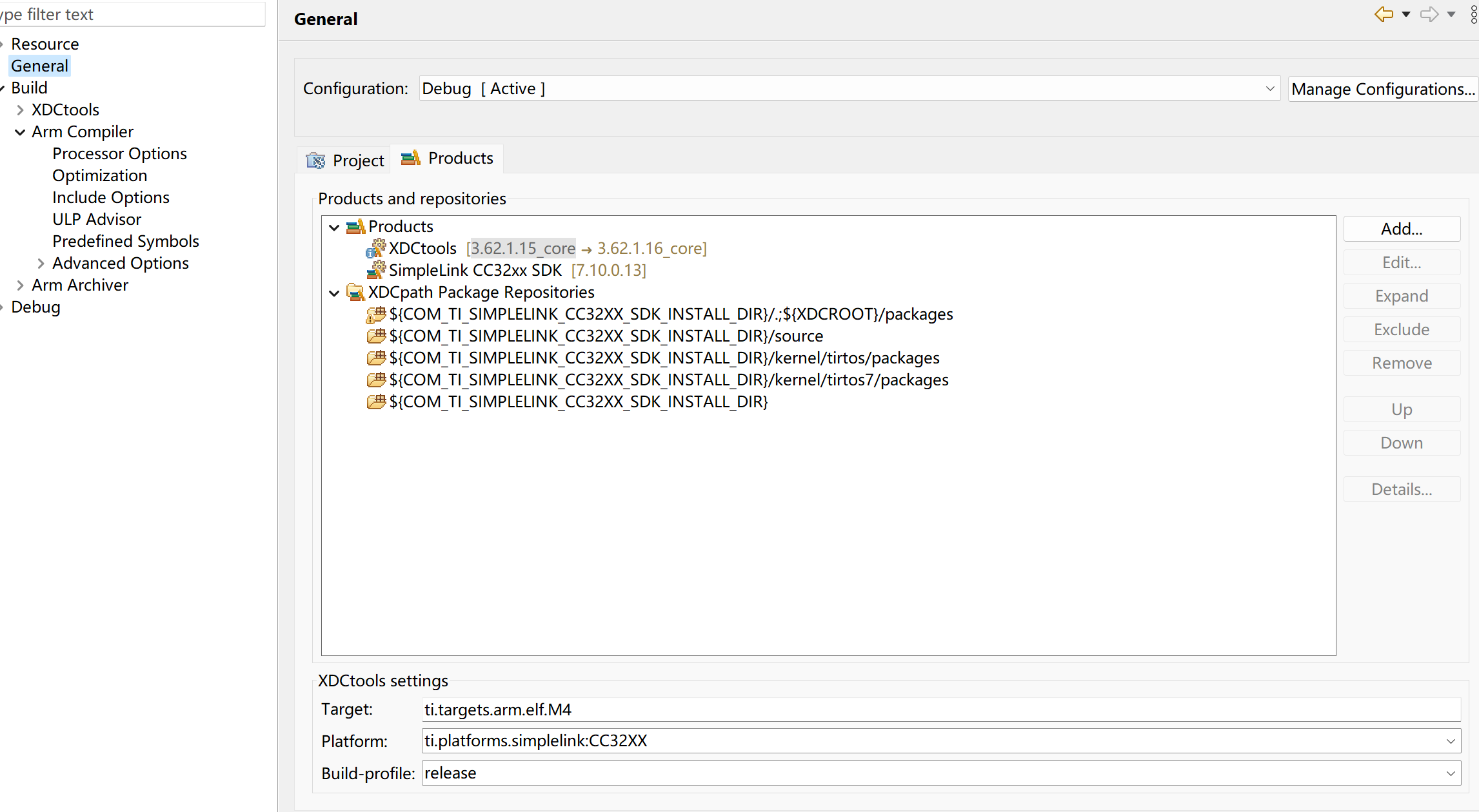

 the CPU I am using now is CC3235S, and the original project used CCS10.4.0+simplelink_cc32xx_sdk_5_20_00_06+sysconfig_1.8.0+xdctools_3_62_01_15_core,
The project can be compiled and passed, and the program can be programmed to the board using uniflash_6.4.0 and executed. However, when the board is connected to the wireless network of its own mobile phone, the TIRTOS timer in the program dies when it repeatedly disconnects from the mobile hotspot.
Then block in the sl_WlanConnect function.
I suspected that the SDK version was too low, so I downloaded the latest SDK--simplelink_cc32xx_sdk_7_10_00_13+sysconfig_1_12_0. However, after the download was completed, the project failed to compile and there were the following compilation errors. What should I do to make the project compile and pass? The problem lies in where?
Description Resource Path Location Type
can't locate the package 'ti.posix.tirtos' along the path: 'C:/ti/simplelink_cc32xx_sdk_7_10_00_13/source;C:/ti/simplelink_cc32xx_sdk_7_10_00_13/kernel/tirtos/packages;C:/ti/simplelink_cc32xx_sdk_7_10_00_13/kernel/tirtos7/packages;C:/ti/simplelink_cc32xx_sdk_7_10_00_13;C:/ti/ccs1040/xdctools_3_62_01_15_core/packages;C:/ti/ccs1040/xdctools_3_62_01_15_core/packages;..;'. Ensure that the package path is set correctly. .xdchelp /tirtos_builds_cc32xx_release_ccs line 592 C/C++ Problem
Cannot build project. Referenced RTSC Configuration project 'tirtos_builds_cc32xx_release_ccs' contains build-errors. Anchor_Lighting Anchor_Lighting Problem

I installed the latest CCS 12.2.0 here, but the project still cannot be compiled. It could be compiled and passed using 10.4.0 before. What should I do next to make my project compile?
Please also help me look at the compilation errors and give me some suggestions, thank you.
The compilation error is shown below.
can't locate the package 'ti.posix.tirtos' along the path: 'C:/ti/simplelink_cc32xx_sdk_7_10_00_13;C:/ti/ccs1220/xdctools_3_62_01_16_core/packages;C:/ti/simplelink_cc32xx_sdk_7_10_00_13/source;C:/ti/simplelink_cc32xx_sdk_7_10_00_13/kernel/tirtos/packages;C:/ti/simplelink_cc32xx_sdk_7_10_00_13/kernel/tirtos7/packages;C:/ti/ccs1220/xdctools_3_62_01_16_core/packages;..;'. Ensure that the package path is set correctly.

XDCpath repository 'C:/ti/simplelink_cc32xx_sdk_7_10_00_13/.;C:/ti/ccs1220/xdctools_3_62_01_16_core/packages' cannot be found! Visit project's 'Properties > General > Products' tab to adjust the XDCpath.

    I suggest to look into one of the examples in the new SDK and understand how the projectspec is built. It is different than the old SDK. For example, the kernel library is located in a different location in the SDK.
    See this E2E post for example https://e2e.ti.com/support/wireless-connectivity/wi-fi-group/wifi/f/wi-fi-forum/1285480/cc3235sf-package_not_found-build-error-after-updating-sdk
