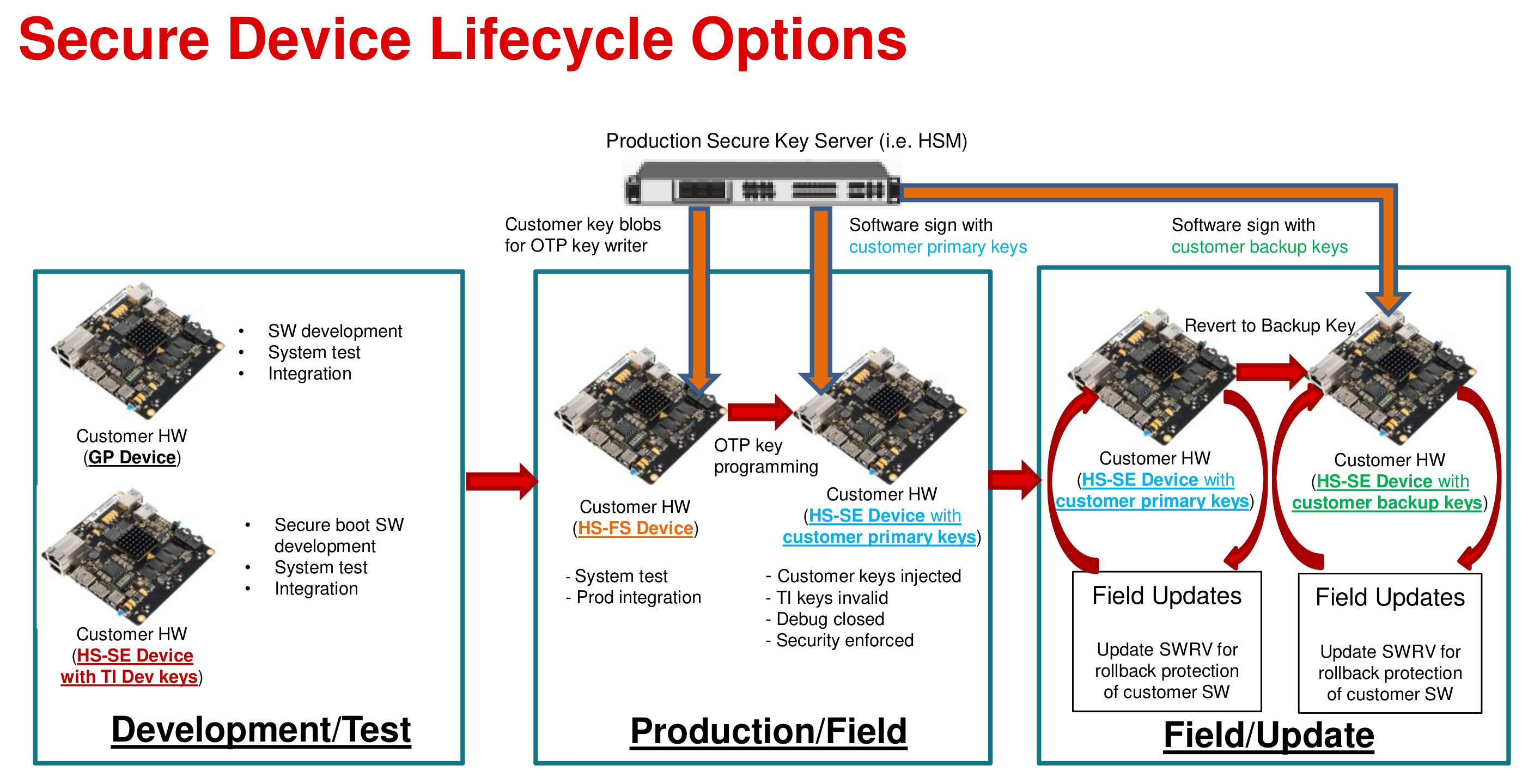

    1. When is VPP required
    The VPP is used to program the eFuse when HS-FS devices are used.
    SoC devices come in two types: General Purpose (GP) & High Security (HS). All GP devices can leave the VPP domains unconnected per DM. Pre-programmed HS devices can also leave VPP supply unconnected if no additional eFuse programming is needed. If it is required to do on-board eFuse programming, VPP supply is required.
    1. Difference between GP and HS-FS hardware design
    The key difference is the SOC and the VPP configuration. You need to supply the VPP supply rail during the time that eFuses are programmed,

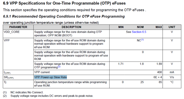

    1. What are the VPP voltage and current specs?
    Refer section in the datasheet: 7.9.1 Recommended Operating Conditions for OTP eFuse Programming.

    1. eFuse programming steps
    An OTP (One Time Programmable) Keywriter (software tool) is used to program the eFuse. The keywriter  controls the On-Board LDO that is used to generate the VPP supply voltage via a GPIO output.

  • HI Board designers,
    Additional inputs on the VPP supply slew rate
    Refer device specific data sheet section related to VPP
    7.9 VPP Specifications for One-Time Programmable (OTP) eFuses
    This section specifies the operating conditions required for programming the OTP eFuses.
    Note:  The "VPP Slew Rate" parameter name is changed to to "VPP Power-up Slew Rate" to clarify the limit associated with this parameter only applies during power-up.

    Did you read the table note associated with VPP in the "Power-Up Sequencing – Supply / Signal Assignments" table?
    VPP is the 1.8V eFuse programming supply, which shall be left floating (HiZ) or grounded during power-up/down sequences and during normal device operation. This supply shall only be sourced while programming eFuse.
    The power-up and power-down sequences shows a solid line that remains low with a grey area over the solid line. This is attempting to represent the expectation as described in the table note. We prefer VPP to be held at the same potential as VSS during power-up and power-down, but having a Hi-Z connection is acceptable.
    Also read the "VPP Specifications for One-Time Programmable (OTP) eFuse" section in the datasheet for more details.
    Sreenivasa

    A4 Yes, "7.8 VPP Specifications for One-Time Programmable (OTP) eFuses" is VPP electrical specification. OTP Keywriter tool is provided by TI for customers to program customer's key set on HS-FS to convert it to HS-SE to enforce secure boot.

    TI recommends only applying power to the VPP pin during eFuse programming.
    The GPIO controlled LDO adds another layer of protection for preventing rouge software from accidently burning fuses. Software would only need to write a few registers in the eFuse controller module to accidently burn fuses if VPP were always powered. When using a GPIO controlled LDO to source VPP, software would also need to write the appropriate value into the PADCONFIG register of the control module to enable the IO cell output function and also write appropriate values into multiple GPIO module registers to enable VPP. The GPIO controlled LDO VPP source significantly reduces the risk of rouge software accidently burning fuses.
    "TI recommends only applying power to the VPP pin during eFuse programming."
    Please refer to AM62xx datasheet for more details.
    7.9.2 Hardware Requirements
    The following hardware requirements must be met when programming keys in the OTP eFuses:
    • The VPP power supply must be disabled when not programming OTP registers.
    • The VPP power supply must be ramped up after the proper device power-up sequence (for more details, see
    Section 7.11.2.2, Power Supply Sequencing).

    The device transitions from HS-FS to HS-SE only if Customer Keys Revision register is non-zero and Customer Keys Count register is non-zero. Writing of the EFUSE keys Secondary Master Public Key (SMPK)/Back-up Master Public Key (BMPK) will not change the HS-FS to HS-SE.
    Yes, both KEY_REV and KEY_CNT need to be non-zero.

    - a HS-FS is converted to HS-SE (High Security - Security Enforced) once the key revision and key count are programmed on HS-FS
    - It runs ONLY on a HS-FS device, but not HS-SE

    (+) SK-AM62-LP: sequence for enabling secure boot using custom keys - Processors forum - Processors - TI E2E support forums
    I use the AM62X EVM and want to enable HS-SE with custom keys.
    I was able to build the tiboot3.bin from the SDK and using the TI development keys. I have NOT run it on the board, so no eFuses are burnt yet.
    Moving forward with custom keys, this are my steps:
    # 1 Generate a new set of keys:
    ./gen_keywr_cert.sh -g
    # 2 In the keys folder I get:
    aes256.key bmek.key bmpk.pem smek.key smpk.pem
    # 3 Make the One Shot certificate, specifying SMPK as the certificate for secure boot
    ./gen_keywr_cert.sh -t tifek/ti_fek_public.pem -a keys/aes256.key --msv 0xC0FFE --bmpk keys/bmpk.pem -b-wp --bmek keys/bmek.key --bmek-wp --smpk keys/smpk.pem --smek keys/smek.key --keycnt 2 --keyrev 1
    # Output:
    1668 secondary_cert.bin
    5380 primary_cert.bin
    7048 ../../x509cert/final_certificate.bin
    # 4 Convert the bin, produce the keycert.h:
    python3 ~/ti/mcu_plus_sdk_am62x_09_01_00_39/tools/bin2c/bin2c.py final_certificate.bin keycert.h KEYCERT
    # 5 Build the tiboot3.bin
    ti-arm-clang$ make -sj clean PROFILE=debug
    ti-arm-clang$ make -sj PROFILE=debug
    # Output:
    ti-arm-clang/sbl_keywriter.debug.tiimage Done !!!
    ti-arm-clang$ md5sum tiboot3.bin
    db3eca1de8d2e0ccb811016691a265c8 tiboot3.bin
    # 6 Install the custom signing key in the u-boot source tree, replacing the TI development key:
    copy keys/smpk.pem to board/ti/keys/custMpk.pem
    # 7 Rebuild u-boot, now signed with the new custom key.
    # 8 The tiboot3.bin is loaded by dfu boot, it is executed and burning the eFuses.
    # 9 After a board reset the CPU state is now HS-SE and only my new signed u-boot will execute.
    Is this procedure complete and valid?
    Additional questions:
    Q1. Two sets of keys are loaded, my keyrev specifies 1 (SMPK). When is the BMPK used then?
    Q2. Should I leave board/ti/keys/custMpk.crt and board/ti/keys/custMpk.key untouched?
    Your summarized steps for programming OTP efuse and signing u-boot looks good.
    Some reference on your questions:
    https://e2e.ti.com/e2eprivate/processors-security/processsors_security_support/f/processsors-security-support---forum/1202686/faq-am6442-how-to-use-the-tisci-apis-read_keycnt_keyrev-write_keyrev-to-activate-the-backup-key-set
    https://e2e.ti.com/support/processors-group/processors/f/processors-forum/1294191/am625-what-is-the-function-of-custmpk-crt-file-how-to-generate-this-file-using-customer-own-key
    Fyi, I sent an invitation for you to join the special security e2e forum to discuss security related questions.
    Here is a summary on authentication flow on HS-SE (Security Enforced)
    1a/. hash(SMPK) check against SMPK-H programmed in OTP eFUSE
    1b/. the self-signed x.509 certificate is verified with the SMPK embedded in the x.509 certificate
    2/. the hash(binary blob) is checked against the hash in the x.509 certificate
    On HS-FS, 1a/ is skipped which makes the self-signed x.509 certificate verification pass on HS-FS as expected.

  • Hi Board designers,
    Inputs related to LDO load current transient and recommended LDOs
    Expected load current transient and ROC (during load current transient)
    LDO load transient response:
    TPS74518 (Voltage outside the ROC)
    Recommended LDOs:
    TPS7A21
    TLV75518
    Sreenivasa

  • Hi Board Designers,
    Inputs related to LDO selection and transient response
    (+) TLV757P: Load transient response for 400mA load transient - Power management forum - Power management - TI E2E support forums
     see the below load transient response
    The load transient expected is 400mA
    Would the voltage transient for 400mA be less than 1A (meaning lesser voltage variation)
    Reference LDO - TLV75518.
    The use case is to program eFuse array for Sitara AM62x family.
    The starting current can almost assumed to be near to zero.
    In this use case you can expect the maximum voltage dip during the transient to be lower. I have attached a measurement simulating this use case.
    Sreenivasa
