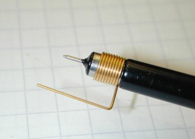

    this can be ground noise. If you have a microcontroller in your circuit this noise can come from the 3.3V supply or can be common mode noise on the signal ground. Best remedy is to use a solid ground plane and to route the analog and digital ground strictly separated from each other.
    I would take such a ground spring and connect it directly to the ground pin of LM2901:
    Are you still seeing this noise at the output of LM2901?
