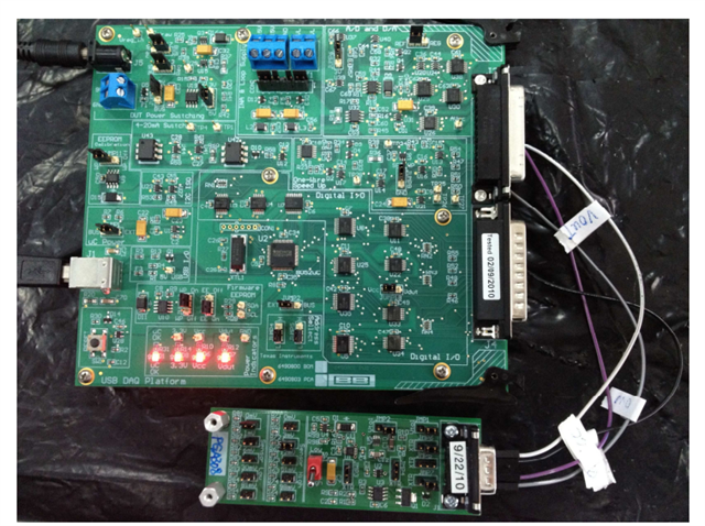

My custom circuit with PGA308 is shown below.R2 is removed for real circuit.
And we try to calibrate this external sensors follow the connection below:
For the calibration steps as below, I follow the PGA308 EVM board steps, but I don't have the calibration procedures for external sensor board.
Issue:
The connection seems work and power supply is good. However,  when we change the bridge sensor output there seems no change in the block diagram and the Vin reading is incorrect.
 From my understanding,  I should change the step 2 from "Use DAC Signal " to "Apply signal externally". But do you have a special configuration guide for other mandatory stetting I should take care. I really need this kind of  suggestion. Thanks a lot.

    It appears that you have connected a multi-cal-test PCA card directly to the USB-DAQ platform. The multi-cal-test PCA card is designed to be used with the larger multi-cal system and is not directly connected to the USB-DAQ. Can you show the connections and test configuration that you are using with your custom board?
    Do you have the PGA308EVM as pictured below? Were you able to perform a successful calibration using the PGA308EVM Software and the onboard signal emulator?
    The PGA308EVM allows an external sensor to be connected using terminals T3 and T5, and configured as the input source using JMP17 and JMP18.
    Follow these steps to ensure the input from the external sensor is as expected and within the common-mode input range of the device. Connect your external sensor to the PGA308EVM as described above, and use a precision multi-meter to verify the input common-mode voltage of Vin1 with respect to GND and the input common-mode voltage of Vin2 with respect to ground. Then verify the differential voltage across Vin1 and Vin2 under no-load and full-load sensor conditions. When loading the sensor, make sure the load is stable and give the sensor adequate time to settle before taking the measurement.
    If these voltage measurements are as expected and within the common-mode input range of the device, the next step is to calibrate using the external sensor, the PGA308EVM and the PGA308EVM software. You will need to change step 2 to "apply signal externally" when using an external sensor. In the block diagram tab, you should be able to see the Vin reading change when loading/unloading the sensor.
    Following the steps above will validate that the sensor signal range and the software set-up are correct and the next step is to attempt calibration using your custom board.

    1. To clarify the connection: I don't have a PGA308EVM in hand and just have the USB DAQ board. I self made a PGA308 Test Board follow the schematic below.
    Bridge sensor---> PGA308 Test Board--->USB DAQ--->PC EVM GUI
    I understand your comments that PGA308EVM can support external sensors. But I am wondering whether my connection could also use the EVM GUI to do Calibration and OTP?
    2. If the answer above is yes, what's the necessary change in the GUI that I should change.
    • For HW connection, in my schematic Vref, Vs and Vexc for sensors , Vclamp  all provide by the VDUT(J3 pin 17 on USB_DAQ)  whether I should change the Vref,Vdut and Vclamp in the block diagram accordingly?

    Yes, you can use the PGA308EVM software to calibrate your PGA308 Test board.
    You do not need to change the values in the block diagram tab as these will be automatically updated when you set the Cal Preset in step 4 of the calibration tab. You will need to set Vref to the correct value and I recommend selecting the "Clamp" setting as well.
    After you update these settings and click "Ok" you will be prompted to save the settings in a .csv file.
    In step 2 you will need to select "Apply Signal Externally" for your external sensor.
    Note that pins ads2 vin+ and ads2 vin- on the USB_DAQ are typically connected to the inputs of the PGA308 to measure the differential input signal. You do not have this connection on your board, which is why the Vin reading on the block diagram page does not change in response to your input signal. You may complete calibration without this connection, as the calibration procedure only requires the output of the PGA308 to be connected to ads1 vin+ which you have connected correctly. For this reason you may select "Use USB DAQ A/D" as your measurement tool in step 3.
