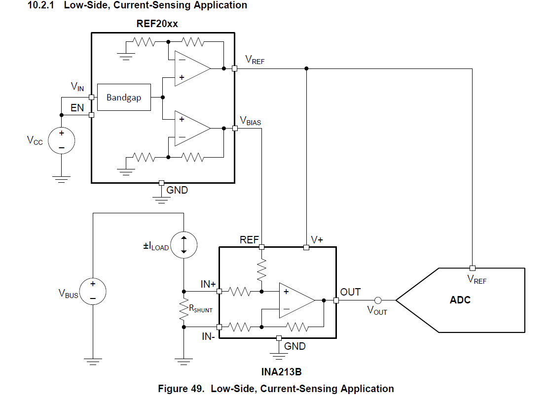

  • Hello Dany,
    It should be fine to use this configuration as unipolar signal.  I would recommend REF2030 this will give you both you an accurate output of 3V and 1.5V without having to deal with resistor tolerances.   On page 18 of the REF2030 datasheet, it shows an application example of using Vref for the ADC and Vbias for the offset of a difference amplifier.   I have also attached a screen shot of it below.

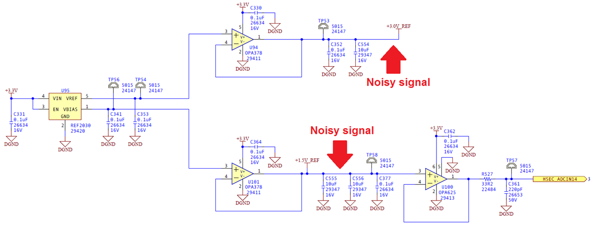

  • Hello Errol,
    We tried to test the ADC with the same circuit configuration you suggested us and the REF2030 for the voltage reference. When we measured the Vbias (Vref/2) with the ADC the signal seems very noisy. The output values are around 2048 with a noise of +/-35 counts. We also tried different voltage sources with the same results.
    I read the following application report and the recommended value for Cfilt is more higher than the value you recommended (220pF vs 115nF). We tried different values of Cfilt and Rfilt to reduce the noise. With a capacitor of 1uF and a resistor of 20Ohm we have better results but it still noisy. The ouput values for Vbias are around 2048 with a noise of +/-10 counts.
    Do you have any recommadation to get better results? What is the source of this noise?
    www.ti.com/.../spna061.pdf
    Best Regards
    Dany

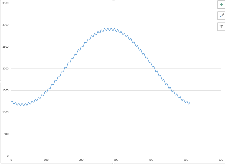

  • This is the kind of results we get with the ADC.
  • Hello Errol,
    We found one problem but still have stange behavior with the ADC. The first problem came from the voltage follower buffer connected to the REF2030.
    The output of each voltage follower was very noisy. Do you know why the OPA378 was so noisy at the output. Is this came from the voltage follower configuration.
    Now we face a problem with the ADC sampling. For some reason we often see multiple samples with the same value. For example, if we have a 60Hz 1Vpp sine wave at the input, we measure a signal of 63.5Vpp at the ouput of the voltage divider. The following image shows the result of the conversion.
    Do you have any idea why we get this kind of result.
    Best Regards
    Dany
  • Hello Dany,
    Looking at the schematic, the capacitance load is too large and is cause instability in the circuit especially with a zero-drift device. The REF2030 device is designed to be able to handle the capacitance max of 10uF for the load. I will post a PowerPoint later today showing simulations and recommendation on the schematic posted.
    Errol
