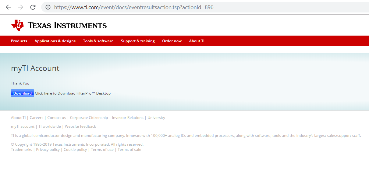

  • Hi Michael,
    If you scan down the FilterPro page you find a line that lists:
    Download FilterPro v3.1
    Following the screens it has you log in and eventually you come to:
    I didn't reload FilterPro V3.1 because I already have it on my machine.
    Yes, the GBW calculation in FilterPro and the other TI active filter programs is in some cases are very conservative, but that is intentional. Certainly, a highly knowledgeable filter designer can use advanced methods to more precisely determine the minimum op amp GBW required to provide accurate filter responses.  However, for most users providing a conservative GBW assures that they will be able to successfully obtain the desired response while investing minimal solution time.
