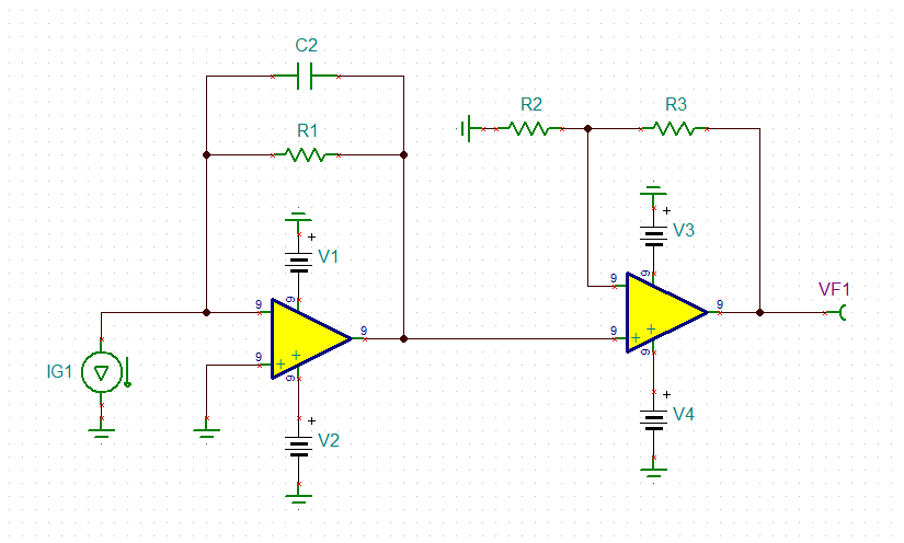

I want to use LMC6001 to amplify very low current. Please refer to the attachment. Could you please review my schematic? Or could you please tell me how to amplify very low current or voltage?
Thanks.

Hi Kevin,
Here are a few more resources on how to design transimpedance amplifiers.
Transimpedance Amplifier Cookbook Circuit
What op amp bandwidth do I need? Transimpedance Amplifiers
1MHz, Single-Supply, Photodiode Amplifier Reference Design
For low level current measurements you must make sure that the input bias current of the op amp is less than the current you are trying to measure, otherwise the input bias current of the op amp will dominate the measurement causing high error. I recommend watching out TI Precision Lab videos on Offset Voltage and Input Bias Current.
You may also need to add a second non-inverting gain stage to the output of the TIA to get the output swing you need.
Thank you,
Tim Claycomb
Do you need DC coupled here?
Do you have a specification sheet on what you are using to generate the current signal?
here you go Kevin, something to get started with,
1. LMP7721 1st stage - it has a brand new 2019 TINA model that internally appears to have 15pF Ccm + 5pF Cdiff - that will be the source capacitance for now,
2. As you increase the feedback R to get the transimpedance gain - you push the required feedback C down to difficult low levels - I went for 2Mohm but then what is called a T network in the feedback to get another gain of 11 in the first stage transimpedance gain
3. This is still quite high BW by itself, so I added a gain of 10 200Hz Active filter to control the noise power bandwidth - Used the OPA376 there,
4. there is an Output DC offset issue here - if you can be AC coupled add a blocking cap into the first filter R
5. Input referred current noise is quite low, but hopefully you can average anyway
Again, just something to get started with, sure there are plenty of modifications you will want to make.
