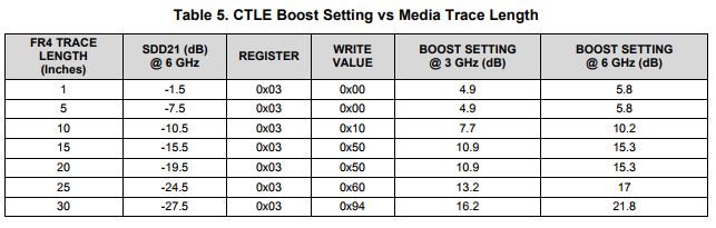

2. At 12G, can you request that they check the lock status and readback the locked data rate? This can be done by following the sequence in Section 4.2.11 of the Programming Guide. If the LMH1218 is unable to lock to the incoming 12G signal, then this may be an issue with incorrect CTLE settings at the LMH1218 input.
3. Please check the CTLE setting by implementing the sequence in Section 4.2.9. By default, the CTLE value in LMH1218 Reg 0x03 = 0x80, which helps to equalize approximately 10-15 in. of PCB FR4 trace. Depending on the amount of trace between the LMH1219 and LMH1218, you may need to apply more or less gain. Please refer to the table below for CTLE boost setting recommendations:

2.At 12G, LMH1218 cannot lock, readback the locked data rate has been Changing.(reg 0x02: 0x9B->0x92->0x89->0x80->A4->0x9B)
3. the pcb trace length about 14in. , the CTLE value in Reg 0x03 = 0x80, /0x50 /etc. The issue still exists.
