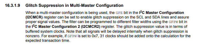

Refer to attached file TI MCU I2C SCL-Spec rev05.pdf
Not sure that I understand your question. The second method with 240 Ohm series resistor and the 4.7K pullup resistor at the end of the line farthest from the TM4C123 looks best to me.
Hi Bob
I'm sorry that my question gave some misunderstanding to you.
So I will send revised Question 6 to you
→ TI MCU I2C SCL-Spec rev06.pdf
Regards, higashi
Sorry, now I understand your question. Yes, the TM4C123 does support glitch suppression (ignores spikes), but it is a programmable option. Please see section 16.3.1.9 of the datasheet. Also the description of the I2CMCR2 register on how to program the glitch suppression width.
