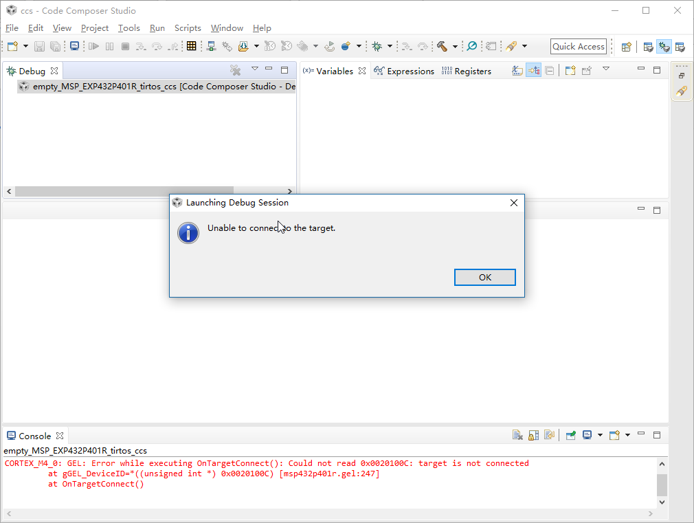

Hi there,
I am searching around for debugging with SEGGER JLINK emulator.
But debugging failed with CCS:
JLINK works fine:
And I wired JLINK with launchpad(red) like this:
1. remove all jumpers expect GND/5V/3V3 from J101
2. connect launchpad with PC via micro-USB port for power supply.
3. connect JLINK with launchpad like this(launchpad<-->JLINK):
RST<-->NTRST
TMS<-->SWDIO
TCK<-->SWCLK
TDO<-->SWO
GND<-->GND

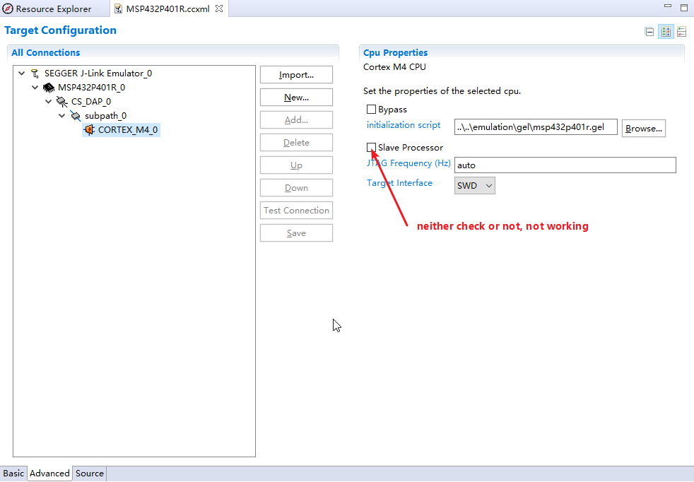

And I chose SEGGER JLINK emulator as debugger in properties->general of project:
Would you please help to find wrong settings what I have made?
Thanks.
