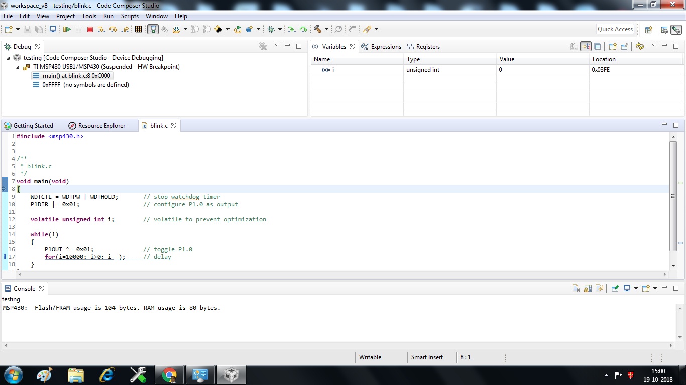

  • #include <msp430.h>
     * blink.c
    void main(void)
    	WDTCTL = WDTPW | WDTHOLD;		// stop watchdog timer
    	P1DIR |= 0x01;					// configure P1.0 as output
    	volatile unsigned int i;		// volatile to prevent optimization
    	while(1)
    		P1OUT ^= 0x01;				// toggle P1.0
    		for(i=10000; i>0; i--);     // delay

    please find attached file.

    i m using Code Composer Studio
    Version: 8.2.0.00007

    Unfortunately, I could not duplicate your issue. Using CCS v8.1.0, I created a new project with 'main.c' for the MSP430F135, copied in your code, saved the project, then downloaded/debugged using a MSP-FET and the MSP-TS430PM64 target board. After the code halted at main(), I could single-step with no errors.
