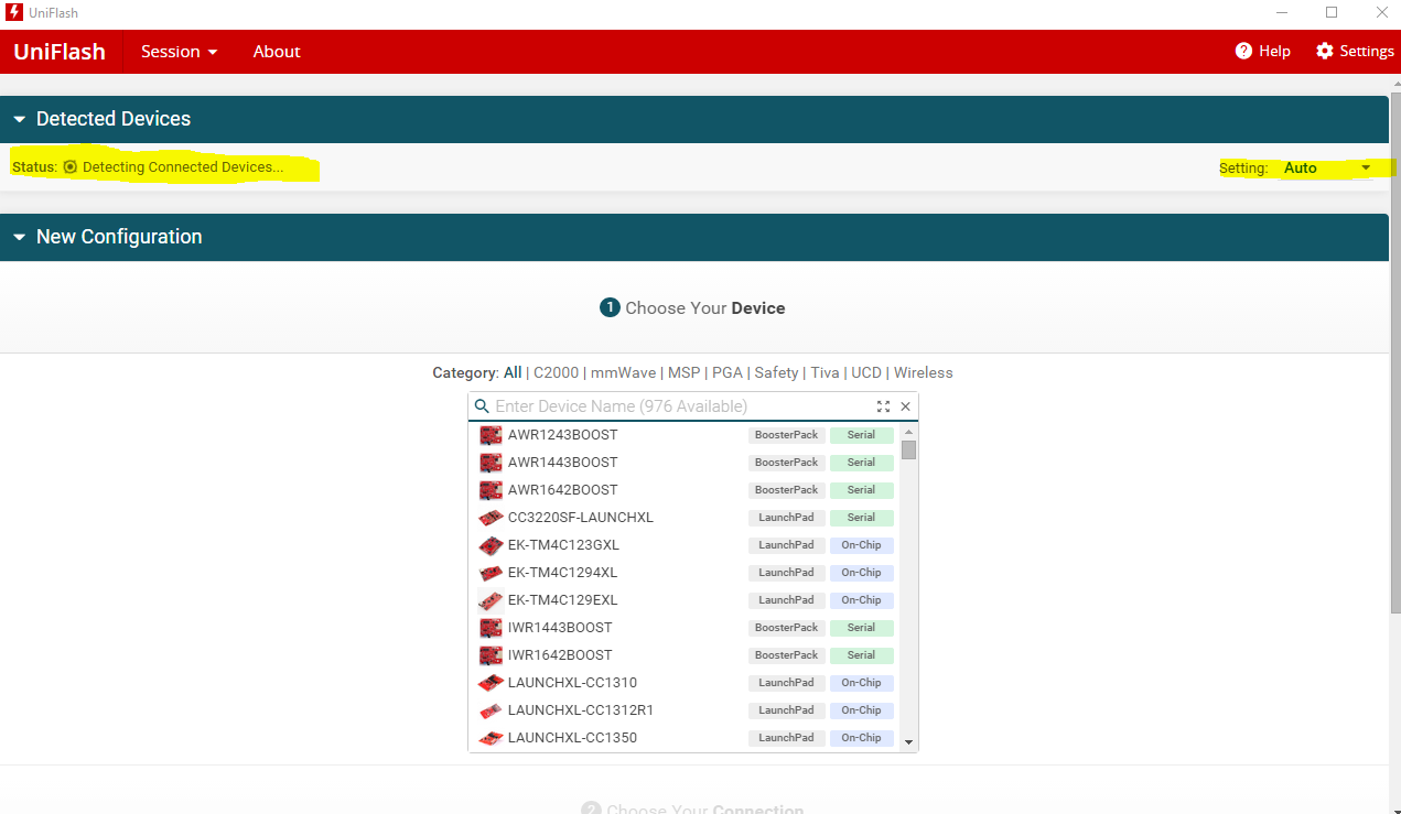

But in the "UNIFLASH" software (v4.5.0) and also on the webpage (dev.ti.com/uniflash) I can only see this text:
"No debug probes/devices detected"
The drivers has been installed, and I can see "MSP Application UART1" and "MSP Debug Interface" devices in device manager. Furthermore, when I click on "Detect" button in "Manual mode", the red LED flashing on MSP-FET device. And the target device reseted.

Is Uniflash set to Auto or Manual mode?
In Auto mode, Do you see Uniflash trying to search and identify the connected device when you plug in the MSP-FET?
If it does search, then it probably recognized the MSP-FET, but it can't seem to connect to the target MSP430. Is the board powered externally or from the FET tool?
- yes, when I plug in MSP-FET, then Uniflash trying to search (like on your picture)

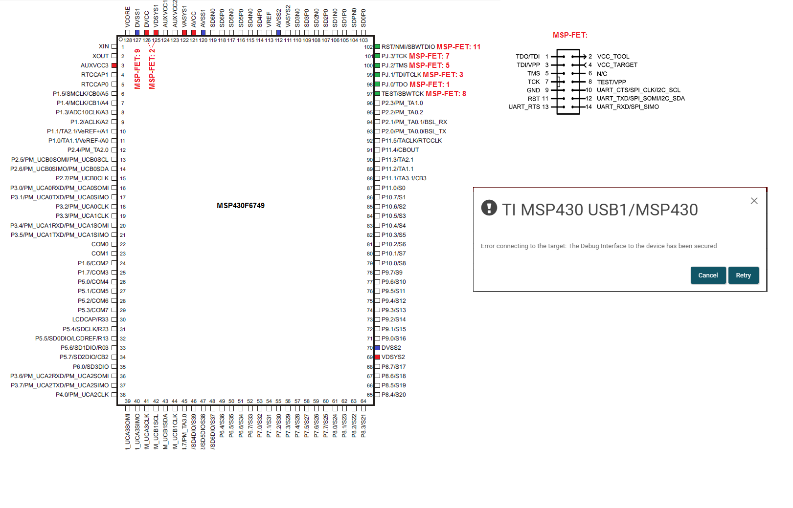

When I running this commands: read device info, erase device, program device, I got this message:
Error connecting to the target: The Debug Interface to the device has been secured
You can see the wiring between the MSP430F6749 device and MSP-FET tool, with the actual message, on the attached image.
(The MSP430F6749 device works well, and I can program the manufacturer's own unique programmer.)
Hey User,
Thanks for the additional information. As for the JTAG connections, these look okay but please see "Figure 2-1. Signal Connections for 4-Wire JTAG Communication" within the MSP430 Hardware Tools User Guide (http://www.ti.com/lit/slau278) for full details on what the recommended programming circuit should be.
user5891320 said:Error connecting to the target: The Debug Interface to the device has been secured
This sounds like the JTAG Electronic Fuse has been blown, locking the JTAG and SBW interfaces. Section 1.11.2 of the Family User's guide describes this behavior for the device.
Has the original manufacturer locked the JTAG interface on the device? If so, they would need to provide the key for BSL access to the device.
