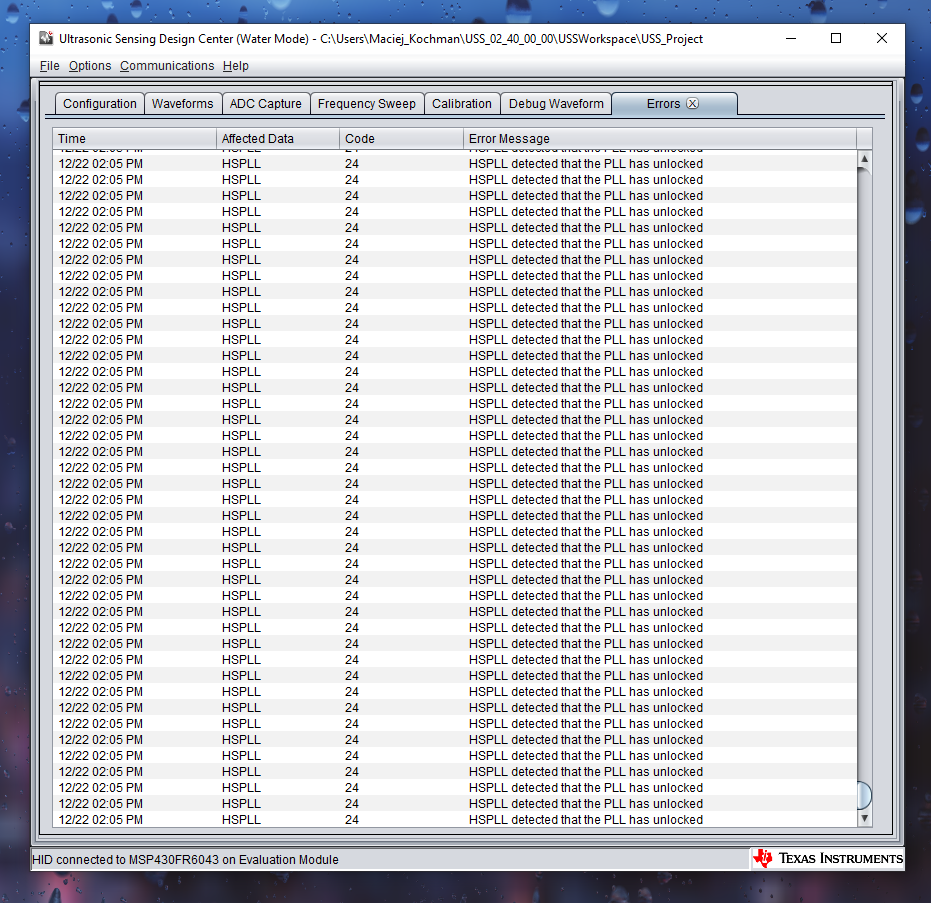

Unfortunately, I'm getting constantly in GUI an error no.24 "HSPLL detected that the PLL has unlocked".
How should I resolve this problem?

  • Hi Johnson,
    Unfortunately, I cannot get the ADC waveform. Please find below screenshots of the main configuration screen, as well as the errors tab.
    Please also find, the logs data gathered using Options -> Logging -> Automatically Log Data
    5415.logs.zip
    Please note, that the custom board is working properly since I've got the correct excitation pulses.

  • Hi Johnson,
    I did more tests.
    I found that if I change the number of pulses in GUI, and update the configuration of the program by pressing the "Request update" button, I see the proper number of pulses on the Oscilloscope.
    Moreover, when I change "UPS and DNS Gap (us)", the time between bursts, also changes.
    Unfortunately, when I set this "UPS and DNS Gap (us)" value to 500. I get a 1.19ms gap on the oscilloscope.
    I was digging further, and I've found that I use 16MHz HF crystal instead of 8MHz used in the reference design "EVM430-FR6043".
    How can I apply this minor change to the "UltrasonicWaterFR604x_02_40_00_00" program?
    Apparently, I don't know if it's related to my main error "HSPLL detected that the PLL has unlocked, HSPLL".
    Best Regards
    Maciej
  • Hi Maciej,
    You use 16MHz Crystal for USSXT?
    You can found the below information, we just support 4MHz ~ 8MHz frequency for USSXT.
    Thanks!
    Best Regards
    Johnson
  • Hi Johnson
    No, we use 8MHz USSXT.
    We use the 16MHz HFXT.
    How can we modify USSWaterDemo to work with a 16MHz HFXT crystal?
    When we use USSWaterDemo unchanged, we experience the program behavior as Maciej described.
    Adam
