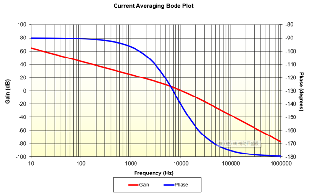

Hi
I am using UCC28019A for power  facror correction.
How can I determine that the phase compensation design of this IC is OK?
Is it sufficient if the gain and phase margins in Figures 30 and 32 are satisfied independently?(Datasheet Figure 30,32)

  • Hello Sir,
    In a stable feedback loop, there is always some degree of phase margin and gain margin.
    In typical DC-DC voltage or current regulation control, the designer typically strives to attain at least 45 degrees phase margin at 0dB gain, and 20dB gain margin at 180 degree phase shift.
    In the UCC28019A, the current loop compensation has limited flexibility for design.
    In the gain/phase plot you posted above, the 0dB crossover is at 10kHz and has ~40 degrees phase margin. At 180 degrees, it has more than 80dB gain margin.  This is less than ideal phase margin, however it is still a reasonably stable loop.
    Higher ICOMP capacitance can decrease the crossover but reduce the phase margin even more.
    Lower ICOMP capacitance can increase the crossover and increase the phase margin, but leave the loop susceptible to reaction to high frequency disturbances and increases harmonic distortion.
    With the UCC28019A, the compensation of the ICOMP loop is a tradeoff between amount of phase margin versus amount of harmonic distortion.
    Ulrich

  • Hello Sir,
    The usual course of design for PFC is to design for stability at maximum load and minimum input line.
    Most people design for phase margin, without worrying about gain margin.
    When the prototype board is constructed, the designer will evaluate operation over the full load and line ranges to verify stability and performance.
    If compensation adjustments are required for any particular set of operating conditions, they are addressed at that time.
    Ulrich

  • There is a column to input the inductance value on the temporary curation sheet, but if I use a coil whose inductance value changes due to DC superposition characteristics, at what timing should I input the inductance value at the current value?
    It is stated that the phase is -80° to -180°/-100° to 0° for current loop and voltage loop, but is it correct to think of the phase margin and gain margin as shown in the figure?
    TI問い合わせ_考え方.pdf
    For calculations with an inductance that changes with DC bias current, use the lowest inductance at the highest peak line current, not the peak ripple current.
    For example, for a 1000W PFC input power at 85Vac, Iin_rms = 11.765Arms.  The peak of this line current= 16.64A.
    For input at cell C57 on the 'CALCULATIONS' sheet, use the inductance of the coil when biased with 16.64A current.
    Your understanding of the phase and gain margins of Figures 30 and 32 in the UCC28019A datasheet is correct.
    The author of the applications section and of the calculator tool apparently calculates the Phase of the Current-Loop response, but calculates the Phase Margin of the Voltage-Loop response.
    I don't know the reason for this inconsistency.
    The results are correct, but the user should be aware that one graph plots Phase and the other plots Phase Margin.
    Ulrich
