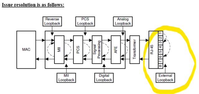

Can you please take a look at the troubleshooting guide and debug their MAC interface as this would be the next step to identify if there is an issue there?
Basic Ethernet Interface Debug With Linux
https://www.ti.com/lit/an/spradj8/spradj8.pdf

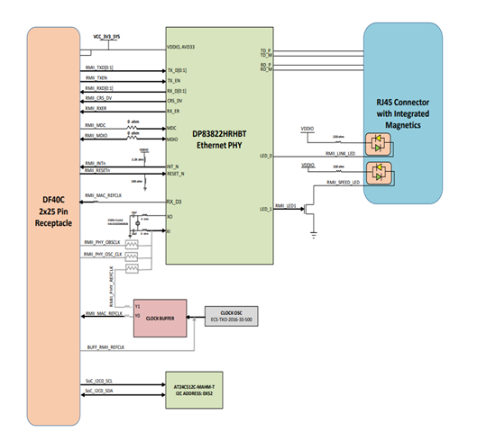

Schematic for RMII
https://www.ti.com/lit/an/snla292/snla292.pdf
/cfs-file/__key/communityserver-discussions-components-files/791/0081.PROC156E1_5F00_SCH.pdf
https://www.ti.com/lit/ug/snlu179/snlu179.pdf

  • Hi Board designers,
    Please refer below RMII connection illustration to follow:

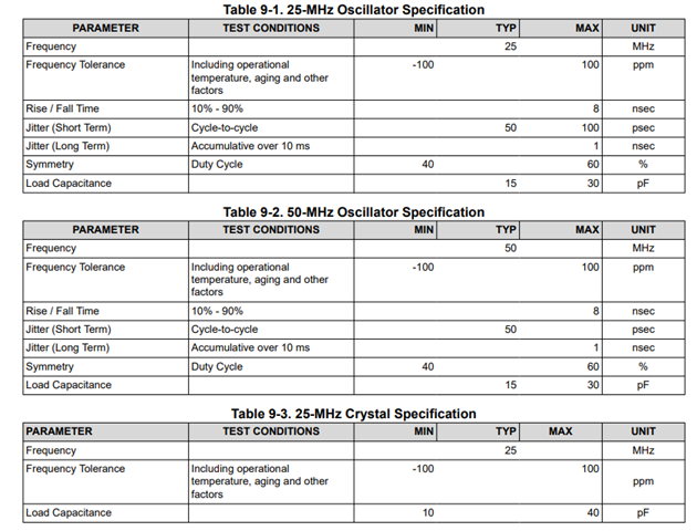

    Operating the PHY with a clock that has 100 PPM accuracy would violate the industry standard. Therefore, this is not supported. We only support a reference clock that has 50 PPM accuracy. The 50 PPM limit must include the initial accuracy of the clock source as well as the temperature variation and aging.
    Query relate to allowed SOC clock frequency
    The only crystal frequency supported is 25 MHz and the maximum deviation from that frequency being +/- 50 Parts Per Million (PPM) when using RMII or RGMII Ethernet peripherals. This limit is defined in the datasheet and means the frequency can only vary +/- 1250 Hz from the nominal frequency of 25 MHz for this use case. The limit doubles when not using RMII or RGMII.

    The spec shows that a crystal with 50ppm or less can be used for Ethernet.  TI’s EVM uses an oscillator instead.  Is there a special guideline for using a crystal?  Panasonic is concerned about the characteristics such as jitter when generating clocks from PLL using a crystal.
     The 50 PPM reference clock frequency accuracy requirement represents a limit defined in the RMII specification. Frequency error expressed in PPM is typically based on a long-term average and is completely unrelated to PLL jitter

    AM62P 25MHz XTAL Specifications
     Let me confirm the specifications of the AM62P 25MHz XTAL.
    Many PHY suppliers and SOC manufacturers require an accuracy of +/- 100 ppm for XTAL for GMII.
    Is the AM62P set to +/- 50 ppm for both RGMII and RMII?
    If you use the RGMII interface, I can understand. But why is the RMII specification +/- 50ppm?
    Also, can't this specification be relaxed?
     Both RGMII and RMII standards require a clock accuracy of 50PPM.
    No, the requirement cannot be relaxed. The requirement is 50PPM when using RGMII or RMII.

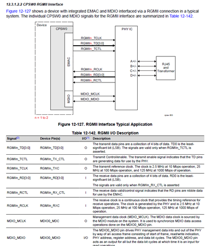

    If possible, can you tell me which part of the specification is listed?
    For RGMII, you can find the limit defined in the TXC and RXC signal descriptions.
    TXC - The transmit reference clock will be 125Mhz, 25Mhz, or 2.5Mhz +- 50ppm depending on speed.
    RXC - The continuous receive reference clock will be 125Mhz, 25Mhz, or 2.5Mhz +- 50ppm.

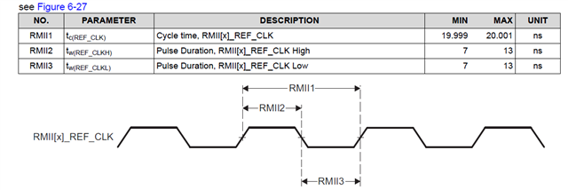

    For RMII, you can find the limit defined in the REF_CLK signal description.
    The REF_CLK frequency shall be 50 MHz +/- 50 ppm with a duty cycle between 35% and 65% inclusive.

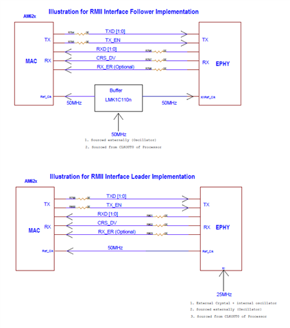

    Refer below inputs related to RMII interface and implementation using AM6x processor families
    Signal Naming conventions:
    For the RGMII signals we are using TDn and RDn as signal names and for RMII we are using TXn and RXn as signal names.
    Wanted to get your thoughts on the naming convention followed and if the signal names have dependencies on the interface specifications.
    We follow the standard on signal names.
    RMII
    RGMII

    You should perform a timing analysis of the interface using the Switching Characteristics and Timing Requirement values from each device (AM335x and attached RMII PHY) datasheet along with actual PCB delays. You may find it is necessary to adjust signal trace lengths to optimize trace delays to provide margin for all timing requirements. For example, you may find the 50 MHz reference clock needs to be injected closer to one end of the reference clock signal connecting the two devices.

    customer wants to use 2x RMII EPHY (DP83826) in slave mode for CPSW. What design/layout challenges does he need to take care? What clock buffer do we recommend to source the common clock for the RMII EPHY and AM64xx?
    is it possible to use the following clock buffer for the RMII-50MHz clock provided by the Sitara?
    https://www.ti.com/product/LMK1C1103
    One output will be routed back to the Sitara RMII-REF pin used for both RMII-Interfaces of CPSW3G
    The remaining two outputs will be routed to the respective XI-pins of DP83826 and all three outputs need to be length-matched, right?
    I believe this can be done with the low skew clock buffer mentioned above. However, it will require careful PCB layout to ensure all timing requirements have margin. The tricky one you need to watch is the MAC min output delay of 2ns and the PHY hold time of 2ns. The PCB delay of the MAC to PHY data path will provide some margin, but it needs to be at least 50ps to account for the max clock buffer skew. You could also place the clock buffer closer to the two PHYs, such that the PHYs see the clock before the MAC. This would add additional margin for this parameter. However, this clock delay difference will impact the margin of other timing parameters. You need to do a careful timing analysis that includes all trace and clock path delays and adjust your PCB delays such that all timing requirements have margin.
    Since both AM64x RMII ports use a common clock, you need to make sure the PCB paths between AM64x and both PHYs have matched delays.
    We are working on a very similar setup with the RMII clock provided by the CLKOUT of the AM6442, but with only one PHY.
    Do we actually need a clock buffer in this case or can the CLKOUT of the AM6442 drive both clock pins like in the picture above? The length between CLKOUT->PYH and CLKOUT->MAC should be matched of course.
    Could you also please elaborate on your explanation above regarding the clock skew? Because, to be honest, I can't quite follow your explanation? Why is the low skew of the clock buffer "bad", making the PCB layout more tricky? How is the data path delay connected to the clock buffer skew? The data is set on the falling edge and sampled on the rising edge of the clock:
    So as long as T2 and T3 are "long enough" there should be no problem. The clock period is 20ns, 50ps clock skew should not significantly influence the timing.
    I would not recommend sourcing two loads with a single clock source. There will be an impedance discontinuity when the signal splits into two paths and this will create reflections that distorts the clock signal. The distortion could cause glitches on the internal clocks of the MAC and PHY. There may be tricks you can do on your PCB to minimize the reflections, but you would need to simulate signal integrity of your specific PCB design to be sure the implementation will not cause problems. Adding the low skew clock buffer is the best approach.
    I never said the low skew buffer was a problem. You actually need a low skew buffer to make this work.
    Let's assume you match the length of each clock path. The clock buffer could insert as much as 50ps of skew, so the PHY could receive the clock 50ps after the MAC.  This could be a problem because the PHY has a 2ns hold time requirement and the MAC may only hold the previous data value for 2ns. It takes some time for the MAC output data to reach the PHY because the of the data path delay.  However, this data path delay must be greater than 50ps to ensure the data arriving at the PHY does not violate its hold time requirement. If the data path is not at least 50ps long, you would need to make it longer, or shorten the clock delay to the to the PHY relative to the clock delay to the MAC. This would add additional margin to the PHY hold time requirement. However, it removes setup time margin.
    Setup time is a function of clock period since data is changed on the rising edge of clock and latched on the next rising edge of clock. Hold time is not a function of clock period since data must be held for a specific period of time after the clock edge that latches data.
    DP83822 clock connection for RMII interface
    Implementing the RMII reference clock:
    SOC CLKOUT0 output must be connected to both the MAC and PHY without causing signal integrity issues on the clock of either device. This is why you must buffer each path of the CLKOUT0, to prevent signal distortion that occurs on the source end of a signal trace from glitching the MAC and PHY clock inputs.
    I have added the expected RMII reference clock connectivity. You need split the CLKOUT0 signal near the input of two equal delay buffers that are spaced very close together. The output of each buffer creates a separate clean RMII reference clock for the MAC and PHY. I have also labeled four delays, where D0 represents the CLKOUT0 trace delay between the AM62Px output and the buffers inputs, D1 represents the delay from the CLKOUT0 split to the MAC, D2 represents the delay from the CLKOUT0 split to the PHY, and D3 represents the delay of data trace between the MAC and PHY. Delay D0 has no impact on RMII timing, so this delay is not important.
    Let's assume the PHY is operating in slave mode and the two buffers are place in the middle of the MAC and PHY, where D1 = D2. If this were the case the MAC and PHY will see the rising edge of the reference clock at the same time and the concern that the MAC is not providing the PHY any hold margin would only be true if D3 = 0. It would be very difficult to locate the PHY close enough to the MAC such that D3 = 0. Therefore, the PHY hold margin for this case would be D3.
    Now let's assume the PHY is operating in slave mode, and you placed the two buffers near the PHY such that D1 is greater than D2. In this case the PHY hold margin would be D2-D1+D3 because the PHY sees the rising edge of the reference clock D2-D1 before the MAC sees the same rising edge.
    You should not place the two clock buffers close to the MAC as this would create a hold time violation.
    Now let me explain why we didn't provide more hold time margin in the MAC output delay. We found several RMII PHYs that are able to source the reference clock when operating in master mode. It that use case the PHY will always see the clock before the MAC, and the PHY setup time margin is a function of the combination of PHY to MAC clock PCB delay, maximum output delay of the MAC, and MAC to PHY data PCB delay. Increasing our min delay causes the maximum delay to get larger and this could be a problem when operating the PHY in master mode if the PCB delays get long. Therefore, we tried to optimize the MAC output delay to work with a PHY operating in slave mode or master mode without requiring very short PCB traces when operating in master mode.

    The T1 is the XI/RX_CLK/Master clock frequency and that TI frequency depends on the specific RMII operation. In RMII Master operation, the DP83826 operates from either a 25-MHz CMOS-level oscillator connected to XI pin, a 25-MHz crystal connected across XI and XO pins. A 50-MHz output clock referenced from DP83826 can be connected to the MAC. In RMII Slave operation, the DP83826 operates from a 50-MHz CMOS-level oscillator connected to the XI pin and shares the same clock as the MAC. Alternatively, in RMII slave mode, the PHY can operate from a 50-MHz clock provided by the Host MAC.
    So in the DP83826 datasheet, please see the clock specification below for the TI.

    DP83TC811S-Q1: Difference between RMII slave and master mode
    What are the difference between RMII Master and RMII slave besides reference clock?
    Do they have difference in power dissipation or other things?
    How to select whether use slave or master by application?
    The difference between RMII Master and Slave is the type of reference clock being fed into the device and whether or not the clock is being shared between the PHY and MAC (Slave). To select one or the other, you can set it by register or strap options. There is no difference except how to supply the clock and the connections
    https://e2e.ti.com/support/processors-group/processors/f/processors-forum/1509548/am6421-clkout-50mhz-for-cpsw-rmii-interface?tisearch=e2e-sitesearch&keymatch=RMII%252050MHz#
    https://e2e.ti.com/support/interface-group/interface/f/interface-forum/1450654/dp83tc811s-q1-how-to-distribute-50mhz-clock-to-multiple-phys-using-rmii/5565641
    https://e2e.ti.com/support/processors-group/processors/f/processors-forum/1342598/am62a7-rmii-reference-clock-connection-with-both-rmii-using-when-external-clock-source-mode
    https://e2e.ti.com/support/processors-group/processors/f/processors-forum/1066687/tda4vm-q1-connection-between-mcu-domain-ethernet-and-main-domain-ethernet-with-rmii
    https://e2e.ti.com/support/processors-group/processors/f/processors-forum/1005567/am6442-two-phy-s-with-one-clkout/3716062
    https://e2e.ti.com/support/interface-group/interface/f/interface-forum/648893/dp83822h-master-slave
    I saw DP83822 have RMII Master and Slave mode. May I know which application have to use Master mode? the difference is clock routing only?
    I don't understand which application or condition I need to use Slave mode
    For RMII Master, the PHY will operate off of a 25MHz reference clock.
    This clock can either be a CMOS-level oscillator connected to XI pin or a 25MHz crystal across XI and XO.
    When bootstrapped for RMII Master, the PHY will automatically output a 50MHz reference clock that needs to be fed to the connected MAC.
    When in RMII Slave mode, the PHY will operate off a 50MHz CMOS-level oscillator connected to XI.
    This clock must be shared between the PHY and MAC. That is the only difference between RMII Master and RMII Slave. It is purely how you supply and route the reference clock.

    Communication Does not work including loopback
    1. link connection was initiated to the external ethernet interface.
    2. External loopback test as illustrated in the figure was executed and observed signals in RX_CLK and RX_Data.
    a. Upon examining RX_CLK and RX_DATA , necessary adjustments are made in the register mapping to compensate the shift.
    b. RGMII[x]_RXC was externally delayed relative to the data and control pins.
    c. Following  clock tuning, we successfully accomplished both external loopback and MII loopback
    (+) TMDS64EVM: PRU-ICSSG Ethernet Port Testing through R5F Core - Processors forum - Processors - TI E2E support forums
    You can skip reading from EEPROM by enabling Manual entry method for filling MAC addresses. You can find this option in:
    Enet(ICSSG) -> System Integration Info - > Mac Address Assignment Method -> Manual Entry.
    Alternatively, you can implement your own function to read the MAC addresses by altering the template function EnetApp_initializeMacAddrPool(), which is located in the file: "$MCU_PLUS_SDK/source/networking/enet/core/sysconfig/networking/.meta/enet_cpsw/templates/enet_app_syscfg_info.c.xdt"
    In this API, you can either stop calling the fillMacAddrList API to completely stop filling MAC addresses, or change the definition to suit your application.
    Please try setting an ID of 2nS on the EPHY side.
    The issue got resolved when a delay of 2ns was introduced between the RX data and RX clock.

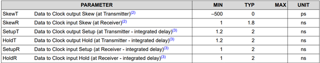

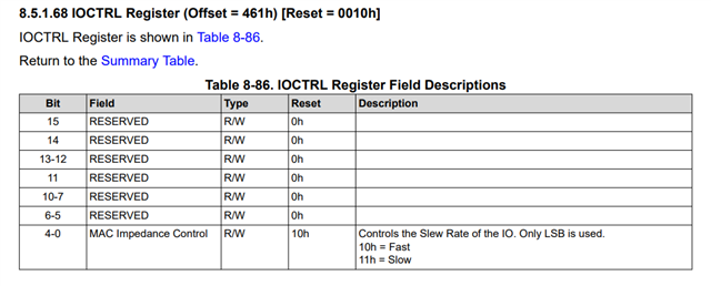

    DP83822H: Why in Clock Shift mode will have 3.5ns delay?
    Why in Clock Shift mode will have 3.5ns delay?  Where is the delay come from?
    This delay is used to help meet RGMII timing requirements noted here:
    As the RGMII timing will be affected by trace length delays in layout, the configurable delay is intended as an option to help meet timing requirements if needed.
    Ethernet PHY DP83822I. They have question regarding determining the delay value of the TX and RX clock.
    They want to configure the value of PHY TX delay and PHY RX delay of DP83822I as shown above. Is there any method to determine it? Once determined, how to configure DP83822I so that it uses that delay value.
    The delay of RX_CLK and TX_CLK could be tune through register 0x0017bit[15:14]. As long as the total delay time between the clock signal and data signal satisfy the setup and hold time, the RGMII signal could read properly.

  • Hi Board Designers,
    Inputs related to RMII interface clock source
    (1) I = Input; O = Output
    (2) n 1 to 2
    Spread Spectrum Clocking support:
    We do support dithering or spread spectrum clocking for RMII
    Can you help me understand if the specs in the below section are the one to be considered for the RMII reference clock inputs.
    Table 6-32. RMII[x]_REF_CLK Timing Requirements – RMII Mode
    The RMII standard requires a clock with a frequency accuracy of 50 PPM.  It is not possible to enable spread spectrum clocking and maintain a frequency accurate of 50 PPM.
    It is not clear how they can do the dithering without violating the RMII standard.  We did not design our MAC to accommodate a spread spectrum clock.  The data buffers used to cross clock domains were not designed to accommodate frequency error beyond what was defined in the RMII specification.
    Additional Inputs
    When reviewing measurements report  with ETH apps team, it was not clear if A62P RMII spec is  an average or instantaneous requirement
    The AM62P RMII clock cycle timing requirement is instantaneous and here is why:
    • The parameter is labeled "Cycle time" — this is a per-cycle (instantaneous) measurement, not an average frequency measurement.
    • The spec window of 19.999 ns to 20.001 ns is extremely tight (±1 ps tolerance, corresponding to ±50 ppm). This is characteristic of an instantaneous cycle-time requirement, not an averaged frequency tolerance.
    • The description explicitly states the clock must be "fixed at 50 MHz" — the word "fixed" implies no instantaneous variation is tolerated, which is consistent with an instantaneous (per-cycle) requirement.
    • If it were an average, the spec would typically say "average frequency" or "center frequency," and the pulse duration rows (RMII2/RMII3) would be irrelevant- but they are equally tightly bounded.
    Spread spectrum / clock dithering intentionally varies the instantaneous frequency cycle-to-cycle. Even though the long-term average remains at 50 MHz:
    • With dithering enabled on the DP83TC817S-Q1, the instantaneous cycle time will vary- exactly what the measurements confirm (48.62–51.36 MHz range, period range ≈ 19.47 ns to 20.57 ns).
    • The measured cycle time range far exceeds the datasheet requirement of from 19.999 to 20.001 ns.
    • The CPSW3G MAC inside AM62P samples data synchronously on every clock edge — if the clock period varies cycle-to-cycle, setup/hold timing for RXD and CRS_DV signals will be violated on those cycles where the period deviates.
    Page 7 has captured Ref_Clk measurements. The measured frequency varied between 48.62–51.36 MHz (range of ~2.74 MHz)
    As already mentioned above, the same ±50ppm accuracy requirement present in the AM62Px Datasheet - Section,CPSW3G RMII Timing / Section, RMII[x]_REF_CLK Timing Requirements – RMII Mode
    It can be easily calculated:
    1/19.999 - 1/20.000 = 10^9 * (1/ (19999* 10^-3) - 1/(20000*10^-3)) = 10^9*10^3 *(5.0002500*10^-5 - 5.0000000*10^-5) =0.000250*10^7 Hz = 2.5 kHz. In the other direction it is the same magnitude i.e. -  50 MHz ± 2.5 kHz means a range of 5 kHz.
    And your measured  deviation delta = 2.74 MHz (48.620000 MHz ... 51.360000 MHz)  that looks like approx. 550 times bigger than the allowed one 5 kHz (49.997500 MHz ... 50.002500 MHz).
    What you could do to resolve the compliance failure is this:
    • In the Register DITH_RFI_EN_CTRL, in Field Dithering Enable [bit 12] you could write 0 to disable the dithering engine
    • In the Register DITH_RFI_EN_CTRL, in Field MAC Interface Dithering Enable [bit 11] you could write 0 to disable the RMII output dithering
    • Either disabling Bit 12 (master enable) alone is sufficient to stop dithering globally, but best practice is to clear both bits 12 and 11 explicitly.
    After these settings RMII REF_CLK should stabilize at 50 MHz ±50 ppm, meeting AM62P-Q1 spec.
