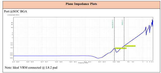

To test PDN analysis SoC and LPDDR4 power line, Customer needs the spec of impedance of SoC/LPDDR4 power line. Could you confirm the impedance?
Here is the plot for the AM62x EVM. However please note that this is an impedance plot of the TI EVM. It should not be used for signoff. The full LPDDR4 system-level simulations must still be run for signoff as prescribed in the LPDDR design guidelines app note.
We only provide impedance targets for VDD_CORE. This information can be found under processor specific section "Example:AM62Ax" (starting on page 31) in the following document: www.ti.com/.../sprac76
As noted in the document, rails not listed are not simulated by TI due to low load transients. For more information, see the device-specific EVM layout for example implementation of these rails.
Other rails like the IOs are highly dependent on external peripherals. From the SoC perspective, if you look at the MAX current ratings for the IOs, the total current (after combining all the IOs of the same voltage) is still very low < 350mA so we don't simulate this rails/No data available.
Regarding your other questions related to PET, the supply names are not expected to match with processor (Example AM62A) pin names because the power estimates in the PET are itemized by supply groups. The power supply consolidation for these supply groups match the EVM.
