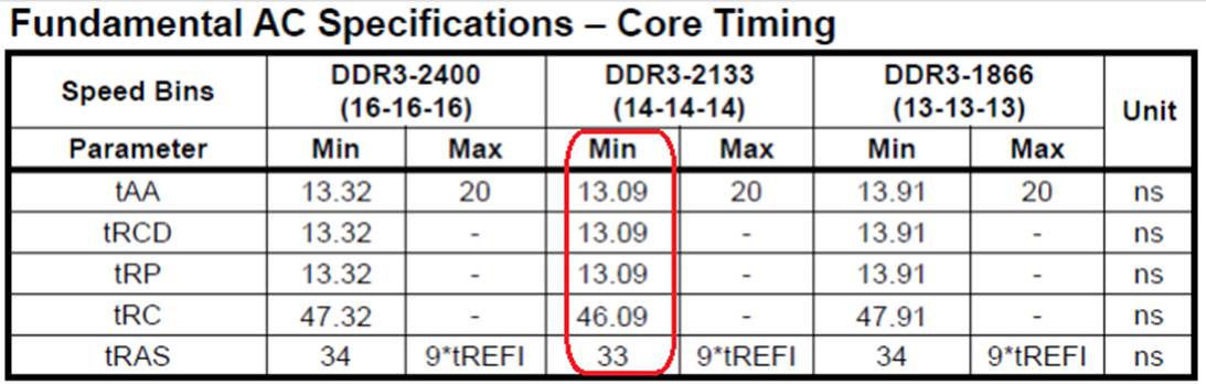

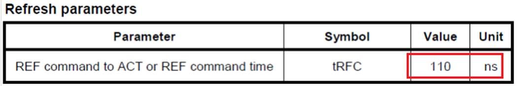

    And also, I would like to check EMIF values and I got confirms it as below from ESMT. Could you please check if below values are right?
    ESMT.docx
    Thanks and Best Regards,
    SI.
