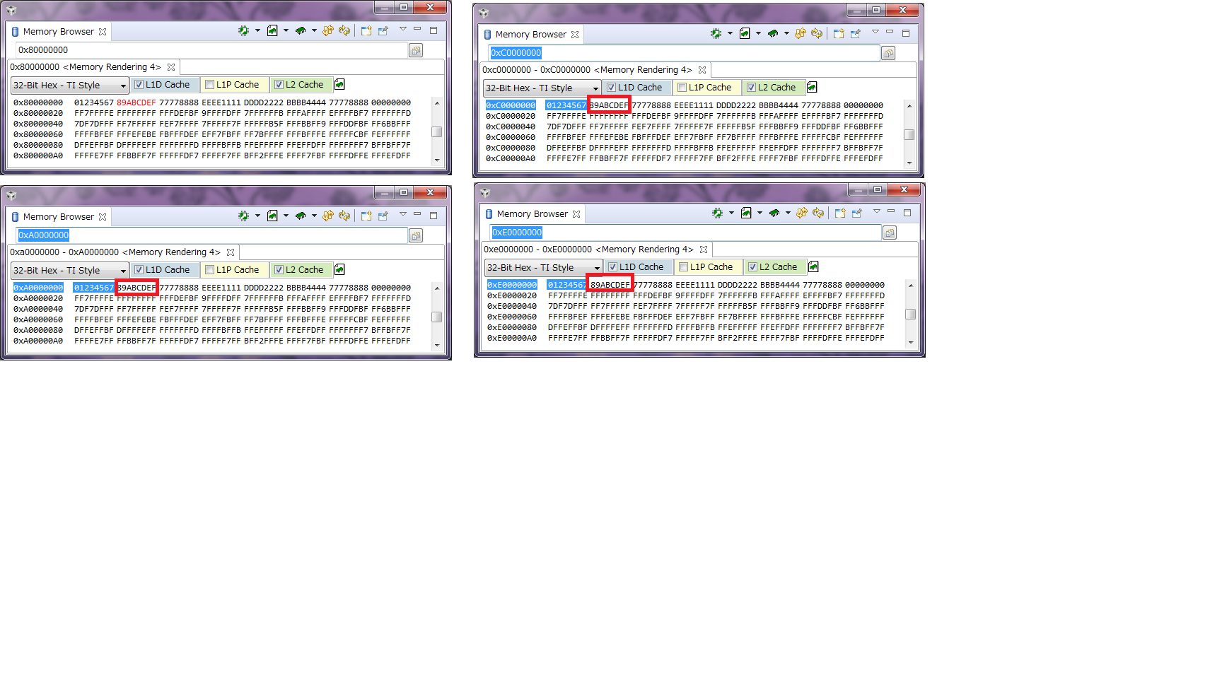

We are developing our product used 66AK2G.
Currently, we are debugging using XDS200 with CCS(code composer studio).
Our using DDR3 is 512MB.
We checked the value writed via DDR3 CCS memory Browser.
The value is mirrored every address 0x2000 0000.
Is this right? We think this is just display by DDR3 CCS memory Browser.
Do you initialize your ddr correctly? You should load the appropriate GEL (arm or dsp) file upon connecting to processor core.
Yordan
