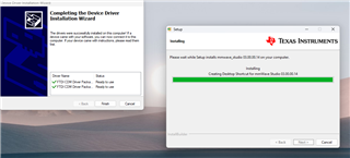

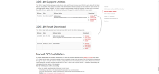

  • Dear Sir,
    I have installed the software ,  I downloaded it from the following link:
    https://software-dl.ti.com/ccs/esd/documents/xdsdebugprobes/emu_xds_software_package_download.html
    Could you please confirm if I have downloaded the correct package?
    Thank you for your assistance.
    Thanks and Regards,
    B. Balu

  • Dear Sir,
    in the above pic  i connected to pc
    Thank you for your guidance.
    I have connected the RADAR_FTDI port to PC. However, the AR-DevPack-EVM-012 (COM115, COM116, COM117, COM118) ports are still not showing up in the Device Manager.
    I have attached a picture of my setup for your reference. Could you please review and advise on what might be going wrong?
    Your assistance would be greatly appreciated.
    Balu
  • Hi Balu,
    For your setup the port numbers will be different. You will not get exactly COM115, COM116, COM117, COM118 ports.
    Can you please attach a screenshot of Device Manager > Ports (COM & LPT)?
    Anirban
