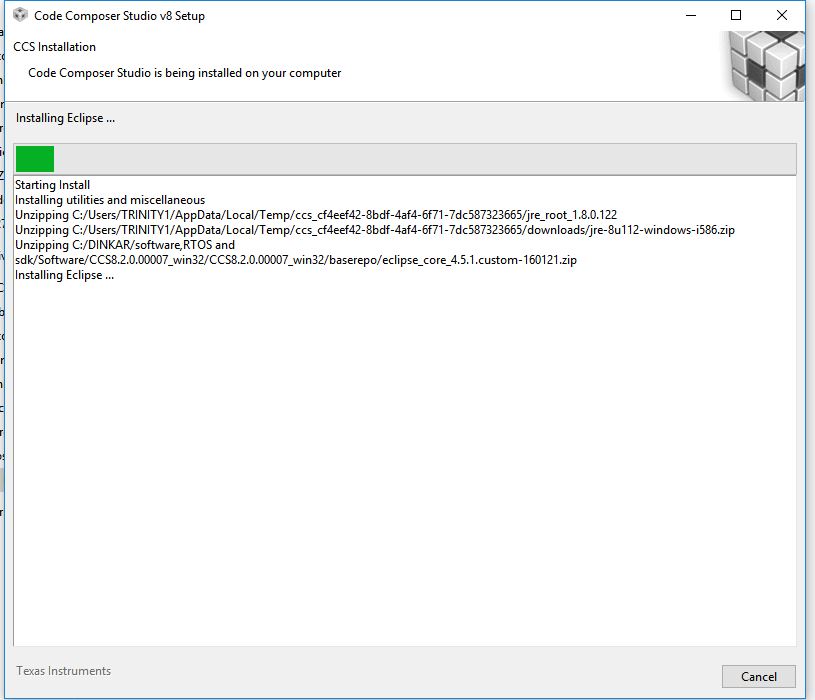

I am trying to install ccs version 8.2.0. but my installation fail every time. try both web and offline installer both.
here i attach log file.
help me to solve this problem.8473.ccs_setup_8.2.0.00007_install.log
The installer path has a comma in it, please move the installer package from "software,RTOS and sdk/Software/CCS8.2.0.00007_win32" to something like "c:\temp\CCS8.2.0.00007_win32" and let me know if that works for you.
