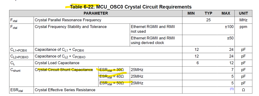

 15. I would like to check the specifications of the 32kHz XTAL connected to the AM62P.
The following are the specifications of the 25MHz XTAL.
Isn't there a specification for the tolerance range drawn by the green line in the 32kHz XTAL?
Let me know your thoughts.

    Refer below inputs for the queries related to the MCU_OSC0 crystal selection.
    1.Recommended crystal frequency for MCU_OSC0
    Recommended Crystal Parallel Resonance Frequency for MCU_OSC0 Fxtal is 25 MHz
    2. Do you have recommended part numbers for Crystal?
    Note that we do not provide part number recommendations.
    The system requirements of a customer’s product needs to be considered when selecting a crystal.  We do not know the operating conditions or frequency tolerance of all attached devices within their system.  The crystal requirements defined in our datasheet only address the processor requirements, but the crystal characteristics may also influence clocks that are sourced to attached devices which have their own requirements. In some cases, the attached devices may have frequency requirements that are tighter than the processor frequency requirements.
    3. Can you help check below specs and confirm this crystal specifications meets the requirements for the MCU_OSC0 Internal Oscillator Clock Source.
    The device expert and oscillator designer reviewed the crystal requirements and agree this crystal specifications meets the requirements for the HF oscillator implemented on our AM64x, AM62x, AM62Ax, AM62P, AM62P-Q1 Sitara processors.

    Verify the crystal selected with the crystal manufacturer to confirm the performance with the processor and also consider parasitic capacitance introduced by the PCB when determining the crystal load cap value.

    9. Is there a real max value for crystal ESR?
    The maximum ESR recommended is 50 ohms regardless of shunt capacitance.

    15. I would like to check the specifications of the 32kHz XTAL.
    The following are the specifications of the 32KHz XTAL
    The accuracy of this clock source is primarily a function of your system requirements.
    We plan to define a max limit of +/-100PPM for the AM62Px device. However, your specific application may require a more accurate source.

  • Hi Board designers,
    Inputs related to Crystal ESR requirements:
    From the datasheet of AM62A7 table 6-22 it is mentioned here what are the limits for shunt capacitance based on the crystal ESR. The examples provided are 30,40 and 50ohms.
    Does this mean these are the only acceptable ESR values?
    Can we use a crystal with 80ohm ESR with a shunt capacitance of 2pF?
    Q1: That is correct, as described in the table note associated with the maximum value of the "Crystal Effective Series Resistance" parameter.
    Q2: Maybe, but we do not have any data points for crystals with an ESR greater than 50 ohms. Most crystal manufactures offer a service for validating your specific design with one of their crystals to confirm it provides enough margin for proper oscillation. I suggest you have your crystal circuit validated by the crystal manufacture if you select a crystal with an ESR greater than 50 ohms. Another option would be to look at crystals in larger packages since they typically have a lower max ESR.
    Note: You must consider the total shunt capacitance applied to the oscillator pins when designing your crystal circuit, which includes the crystal shunt capacitance, PCB trace shunt capacitance, and the AM62Ax package contribution defined in datasheet parameter "XI to XO Mutual Capacitance".
    Therefore, the total shunt capacitance will be larger than the shunt capacitance defined in the crystal datasheet.
    You need to be careful using values in crystal datasheets found on the internet because in most case the datasheet represents an entire family of crystals with a broad range of frequency options. Typically, the higher frequency crystals within a family will have significantly lower ESR than the lower frequency crystals, and publicly available datasheets will publish the worst case ESR for the entire family of crystals. You should ask the crystal manufacture to provide a part number specific datasheet if you want to know the max ESR of the specific crystal you selected.
