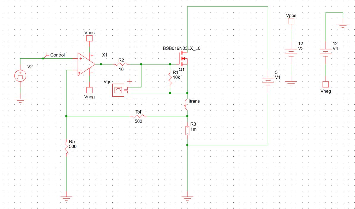

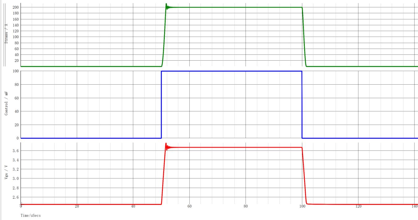

  • Understand the points you raised. The motivation why I asked for devices to replace LT1210 is for spice-based simulation. LT1210 only has LTspice model.
    BTW, I can show you what I'm trying to do as below simulation, following the basic idea of that app note, I'm using ordinary amp as X1 below instead of CFA, and I found it also works.
    So it looks that power amps in TI protfilio is also a good choice.
  • Well thanks for the schematic, that does look like simplis,
    I don't think you need the output drive of the LT part - the FET speed is pretty slow so it does not help you to drive a fast Vgs step in requiring high gate drive - also, if you reduce the gate R and gate current, higher supplies on the op amp are not necessary,

  • Really impressed by your strong interests in this topic and all of these materials. Firstly, a little bit sorry for making you confused.
    I can buy in your opinion of amp output current capability, but here I was only leveraging one FET to verify the general idea, in the actual design with the requirement of hundreds of amps of current, one FET is not enough, the gate resistor is also TBD. What's more, you're considering FET gate input as a single capacitor, but actually sometimes it is complex especially with inductive load switching, there'll be miller effect and miller current which needs continuous high output current from the driver device, to charge Cgd, making Vds drop.
    Anyway, above are not the most important contents here, I'm very interested in your feedback path design. I also find the loop seems sensitive to any one of parameters change in the circuit, showing different ringing and overshoot behavior, related to loop stability.
    Several questions below:
    1. At the beginning, you're just plotting the closed-loop frequency domain response, from input to output(voltage across 1m shunt resistor), to check the resonance(damping ratio), right? How did you come up with the idea to add an extra RC path from output to negative input?
    2. Why you change R+C path to diode+R next?
    3. Why is a bias input voltage like 10mV always there? Why not use 0V input to close the FET(make current 0A)?
  • 1. Putting a power device inside the feedback loop adds a great deal of prop delay (phase shift) that will impair phase margin - the series RC closes the feedback loop at high F with lower phase shift holding it more stable
    2. What happens to the loop when the FET cuts off? You need a feedback path for that case to keep from going open loop
    3. I was just testing the FET on condition, FET off, at zero, is a tough spot for the loop to operate.
  • It seems not a must-have for feedback when FET cuts off, right? Because in the application note Jim wrote, CFA LT1210 seems having the same issue.
  • Well what Jim did might work, I am normally concerned about the loop opening up on any part of the operating range as it will have an unspecified recovery time to linear operating region - that might be fine for what you are doing, but will not be supported in any public sim model - the full internal transistor models do better but those are depending on modelling accuracy for saturated and off transistors coming back into linear region.
