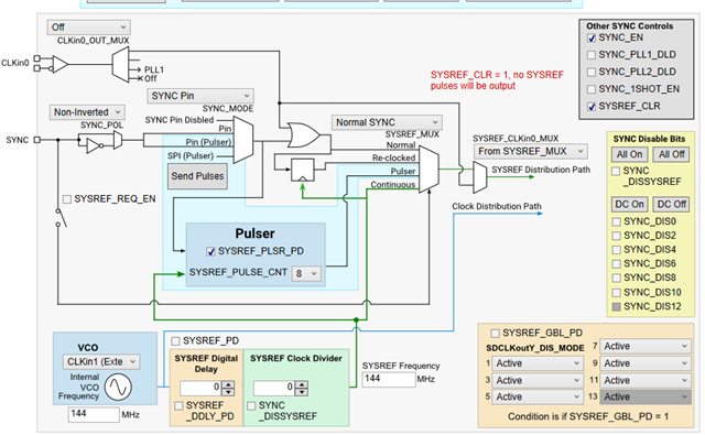

    I think I am a bit confused about your SYNC pin usage. You mentioned that you are supplying a 9 MHz signal?
    And I understand that there seems to be a duty cycle skew. Could you share your configuration file (either as a .tcs file or as a hex file) and your clock tree? I just need to get an idea of your inputs and your buffer configurations.
    Michael
  • Yes, it supplies a plus 9MHz signal to the pin and outputs it as SDCLK ​​in divider mode.
    Input 144MHz as CLKin and set it to FIN mode, then divide it down to DCLK in that mode and output it.
    The peculiar thing is that the above programming satisfies 50% duty cycle on some chips, but does not occupy the chip on some.

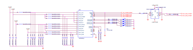

  • I am using multiple LMK04828s on one board.
    Some LMK04828s output a duty cycle of (SDCLK)50%, while others output a duty cycle of
    (SDCLK)56%. I tested multiple boards to see if it is a board-specific issue, and the duty cycles are all different for each board
    so I suspect it is a LMK04828 chip-specific issue.

  • Personally, I think there is no problem in programming since there is LMK04828s that satisfy the duty cycle of (SDCLK)50%.
    However, although it should generally satisfy the duty cycle of 50%, can there be an error of 1 clock of the dclk frequency((SDCLK)56%)?
    When you say that the SDCLK duty cycle is different by 1 clock time of the DCLK, do you mean that it differs by the length of one period of the DCLK (6.944 ns)?
    Additionally, instead of setting your SYSREF_MUX to Normal SYNC mode, could you try setting it to SYSREF Continuous mode? SYSREF Continuous mode is what will result in the desired SYSREF outputs. They will be output as soon as the first SYNC event occurs.
    Finally, could you provide a scope shot showing the differing duty cycles?
    Michael
  • Yes, that's right. It's different by one cycle of DCLK (6.944ns).
    sysref continuous mode is fine. However, it becomes a problem when using external sync.
    I need to distribute and use externally input synchronous signals.
    I can't use internal sysrefs.
    DUTY CYCLE does not appear in various forms between 50% and 56%, It only outputs 50% or 56%.

    Looking over your configuration, I am a bit confused as to why you set the SYSREF divider value to 0. I would expect that to result in some unanticipated behavior. Would it be possible for you to set that to 1, and then instead of inputting a 9 MHz signal to the SYNC pin, could you just input a single rising edge? The SYNC pin phase aligns the output dividers and is required to output a SYSREF signal - you bypass the output dividers so that should not be an issue, but you need a SYNC event to generate your SYSREF outputs. The fact that you have a 9 MHz signal going to the SYNC pin means that your SYSREF outputs will be muted and re-aligned 9 million times per second - I have a feeling that is the source of the duty cycle distortion.
    Michael
  • Okay, I see. Let's set the sysref divider value to 1 and input a single rising edge with snc_pol as shown below.
    The fact that you have a 9 MHz signal going to the SYNC pin means that your SYSREF outputs will be muted and re-aligned 9 million times per second - I have a feeling that this is the source of the duty cycle distortion.
    => If the above is the cause, how about inputting ClKin0 instead of sync pin?

  • The fact that you have a 9 MHz signal going to the SYNC pin means that your SYSREF outputs will be muted and re-aligned 9 million times per second - I have a feeling that this is the source of the duty cycle distortion.
    => Among the many lmk04828s I am using, some output 50% duty cycle.
    How should I interpret this?

    The CLKin0 and SYNC pin work identically for SYNC functionality. A SYNC event requires a single rising edge or a single toggle of the SYNC_POL bit. Inputting a CLK signal to the input pin configured for a SYNC signal will result in inappropriate behavior.
    => Among the many lmk04828s I am using, some output 50% duty cycle. How should I interpret this?
    You mentioned that the 56% duty cycle only appears on the SDCLK outputs. This could be explained by the way the SYNC pin is being treated. You bypass the output dividers for all of the DCLK outputs - meaning the DCLK outputs are unimpacted by any SYNC event, since the output dividers being re-aligned has no bearing on the outputs. However, the SDCLK outputs will be impacted, since a SYNC event is required to generate SYSREF outputs. But now you have confused me a little. Are your SYSREF outputs 144 MHz or 9 MHz?
    Michael
  • SYSREF output: 9mhz
    DLCK output: 144mhz
  • Doesn't the degital logic of SYSREF use the clock of vco(clkin1,external VCO,144mhz)?
    So I thought that sdclk duty 56% is related to 1clock time of 144mhz
    dclk output <= VCO(144mhz)
  • Isn't setting the sysref divider value to 1 used when an internal SYSREF occurs? I'm using external SYNC
  • Hi again,
    I think I have a better understanding of your system now. You input 144 MHz into CLKin1 and use distribution mode to send that to the output dividers - which you bypass.
    You cannot re-clock your 9 MHz input to the SYNC pin along the SYSREF distribution path. However, you can re-clock your SYSREF signal through CLKin0. I have attached a configuration that I used to get this to work. I input 144 MHz to CLKin1, which was sent to the DCLK outputs. I also input 9 MHz to CLKin0, which I routed to the SYSREF_MUX. I chose re-clocked as the SYSREF output mode, and chose CLKin0 as the signal to send along the SYSREF distribution path. I was able to see a 9 MHz output with a 50% duty cycle at the SDCLK outputs.

    Your SDCLK output only appears when the digital delay circuitry is not bypassed. Does it still appear when the number of cycles is increased? Does it appear for 3, 4, or 5 cycles? Does it still occur with the update configuration?
    And when you say that you can't re-clock, does that mean that SDCLK ​​​​​​​​DIGITAL DELAY doesn't work?
    No, what I mean by this is that you cannot use the SYNC pin to re-clock your signal to the SYSREF path. The circuitry of the SYNC pin is not such that a clock signal may be fed into it, you should be using CLKin0 to do this.
    Michael
