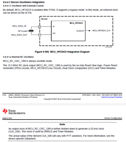

    6. Can I use an oscillator as the clock source?
    Refer 7.10.4.1.2 MCU_OSC0 LVCMOS Digital Clock Source of the device-specific data sheet. Follow the recommended XO termination.

    12. It is assumed that when a crystal connected externally has a large change in frequency due to some factor, there will be an effect on the PLL.
    I would like to know the effect on the PLL when the frequency changes and how each function will operate. The factors that may cause the frequency to change include initial failure, environment, and manufacturing defects.
    Ans: It is not possible for crystals to have a large change in frequency. They have a very high-Q impedance response. The impedance drops dramatically with a very small shift in frequency, which would cause the gain in the oscillator feedback path to drop such that it is not possible to maintain oscillation. So, they are either oscillating at their designed frequency are not oscillating.
    13. Does the 25MHz XTAL has an oscillation margin switching function and is there need to configure registers.
    No HFOSC0 registers are required to be changed. These registers should remain in their default state.
    Select the appropriate crystal circuit components that are compliant to the values defined in the MCU_OSC0 Crystal Circuit Requirements table.
    Read the Load Capacitance and Shunt Capacitance sections to select the appropriate crystal circuit components.

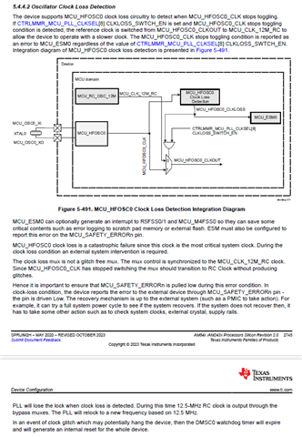

    Queries related to SOC start-up with crystal not operating
    Will it switch to CLK_12M_RC even if HFOSC0 is not oscillating at cold start?
    [TI] >> By default MCU_PLL_CLKSEL_CLKLOSS_SWTCH_EN is set to ‘0’. So at cold start, if HFOSC0 is not switching then the mux will not switch to CLK_12M_RC. If HFOSC0 is not switching during cold start, the device will not boot-up.
    Did you have a chance to power cycle the board and see the behavior with the oscillator disabled.
    5.4.4 Device Oscillators
    The device has the possibility to source clocks of an external high-frequency oscillator - MCU_HFOSC0. The
    device has also one internal RC oscillator - MCU_RC_OSC_12M.
    Oscillator Clock Loss Detection
    Observation clocks

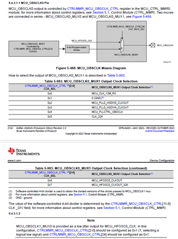

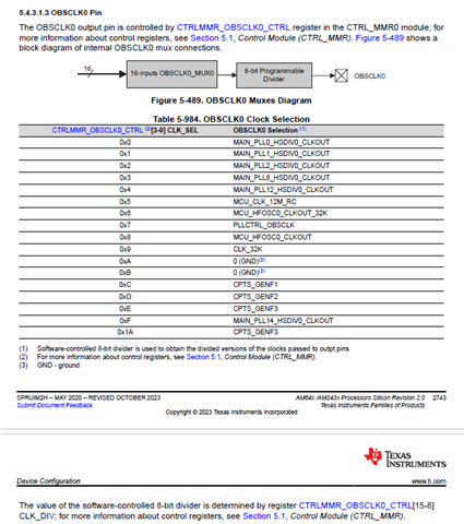

    One more observation we had capture, we monitored the OBSCLK0 output using an oscilloscope. We mapped the OBSCLK0 pin to output MCU_HFOSC0_CLKOUT:
    • When the 25 MHz external clock is active, we observe 25 MHz on the oscilloscope.
    • After the fallback, the output changes to 12.5 MHz.
    • However, when the external 25 MHz clock is re-enabled, the oscilloscope again shows 25 MHz, but the processor continues to run on the internal 12.5 MHz clock.
    Sreenivasa
  • Hi Board designers,
    Refer below inputs for AM62A3-Q1: Oscillator Clock Loss Detection. This should be same for all the AM62x devices.
    If MCU_PLL_CLKSEL_CLKLOSS_SWTCH_EN is set, when HFOSC0 stops, will it automatically switch to CLK_12M_RC and output to the MCU_ERRORn pin at the same time?
    [TI] >> Yes.
    Which register can be used to determine that it has been automatically switched to CLK_12M_RC?
    [TI] >> You can read ESM event register WKUP_ESM0_ESM_LVL_EVENT_IN_13
    Does the oscillator return to HFOSC0 when a warm reset?
    [TI] >> I am not sure if I understand this question. When HFOSC0 starts switching again the reference clock will be automatically switched to HFOSC0 clock.
    Accuracy of the MCU_RC_OSC_12M
    https://e2e.ti.com/support/microcontrollers/arm-based-microcontrollers-group/arm-based-microcontrollers/f/arm-based-microcontrollers-forum/1431627/am2431-accuracy-of-the-mcu_rc_osc_12m
    (+) [FAQ] AM6422: How to Switch Back to External Clock After Clock Loss Detection - Processors forum - Processors - TI E2E support forums
    We tried the power cycle of AM64x and observe 2 cases:
    1. Ocsilator Disabled: AM64x doesn't boot up.
    2. Ocsilator Enabled: AM64x runs on 25MHz clock.
    We modified the config to enable clock loss detection as mentioned in above post. Then we did the warm reset of AM64x and observe the following scenarios:
    1. Ocsilator Disabled. Clock losss detected and after watchdog reset / warm rest AM64x runs on 12.5 MHz.
    2. Ocsilator Enabled: AM64x continued running on 12.5MHz not switched to 25MHz.
    We monitored MCU_SAFETY_ERRORn pin, during clock loss detection pin status changed from HIGH->LOW. However, there is no transition detected when 25MHz clock available again.
    I added the inputs from out reset expert:
    The expectation is that the fault is routed to the ESM, and some external circuit would generate a power cycle or cold reset so the system can recover.  I think this is the only way the clock loss detection circuit would reset the detection.  Also, MCU_PORz is the only way CLKLOSS_SWITCH_EN bit gets reset.  So a warm reset will not help here, and that is why they observe the 12MHz_RC still clocking the processor after a warm reset
    The RC clock backup is not available immediately after PORz because of the default value of CLKLOSS_SWITCH_EN.  There is some setup that needs to happen anyway, in that the error needs to be routed to the ESM to trigger the ERROR signal, so that an external can do something about it (power cycle the device, for example).  When all that is setup, the RC clock will clock the device after a fault, but it is only intended to keep the ESM alive to generate the appropriate ERROR signal.  It is not expected that the device will operate fully.
    On a cold reset, if the 25MHz is not available, the device will not boot.  Even if the clock loss detection circuitry works at that point, the CLKLOSS_SWITCH_EN defaults to 0 as mentioned previously, so the mux will never switch to the RC clock.  Even if it would be able to switch, the ROM does not support booting with that input frequency.
    Sreenivasa
