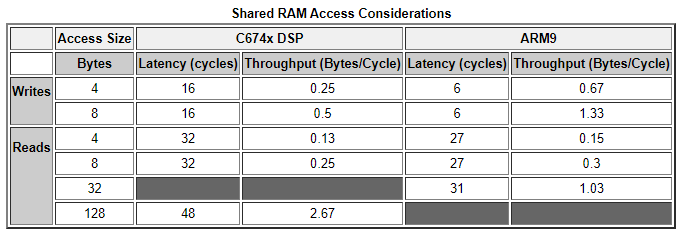

    We do not have any DDR benchmarks available. However, there is some data on shared ram access below which should be similar to DDR, minus the DDR refresh and access latency.

         I am confused:
         Q1: Following the table you give, the ShareRam read speed could be 2.67Bytes/Cycle when ACCESS Size is 128.
                So, I think the throughput should be: 2.67*456M=1217MB/s?Am I right?
         Q2: Do you think my 567MB/s result for ShareRam is reasonable?
         Q3: Why did you say " there is some data on shared ram access below which should be similar to DDR, minus the DDR refresh and access latency. "
         Q4: Do you think my 340MB/s result for DDR2 is reasonable?

  • Frank
    The access size in Sahin's response will depend on the master, the 4,8 bytes etc is CPU load/stores.
    The best throughput or utilization for Shared RAM or DDR will come when using the EDMA , as that is when the default access size is the ~ 64 bytes ( EDMA default burst size) for linear memory to memory transfers. With DMA you can get close to 80% utilization of the theoritical max of the Shared RAM or DDR.
    Some EDMA throughput data can be found
    For CPU load/stores your throughput will be limited by CPU's  read/write access size for load/stores, which will not fully utilize the bus. The 32 and 128 byte for ARM and DSP in the table Sahin posted is for "cache line size" accesses.
    The throughput will not depend much on the DDR2 memory type etc. Configuration wise just use the timing calculator for DDR that was also provided in Sahin's post.
    Mukul
