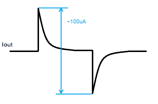

two issues come into my mind. There could sit too much undesired stray capacitance across the barrier between GND1 and GND2. Or the low pass filter labelled with "Rflt Cflt" is not properly working.
Can you measure the voltage across…

Is the issue occurring on several XTR116 devices or just one device? If this is occurring on one device, is it possible to replace the device?
If the issue is showing on a few devices, could you please post the complete schematic and PCB layout…
The IRET pin has no connection to the GND of the current loop. I designed the circuit by following the forums that they should not be combined.
DAC and MCU are powered by XTR116. However, because the XTR116 draws too much current, I disabled these connections…
