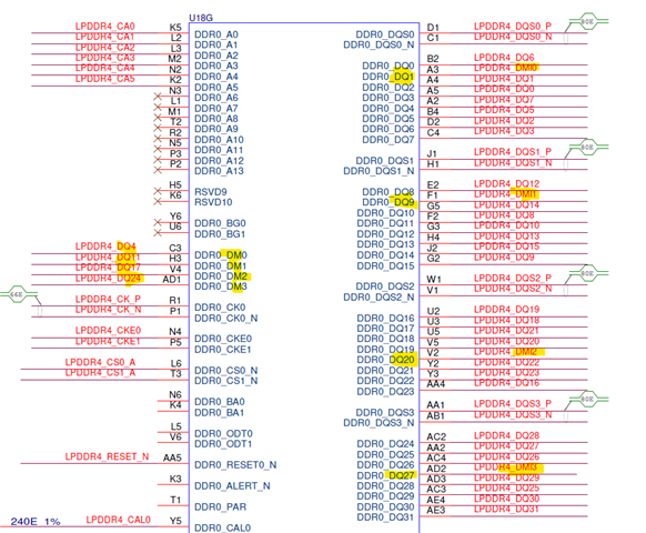

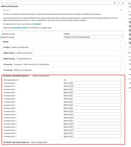

7. LPDDR4 Bit swapping for AM62A and AM62P
Refer Channel, Byte, and Bit Swapping section of AM62Ax/AM62Px LPDDR4 Board Design and Layout Guidelines
8. LPDDR4 Bit swapping for AM62X, AM62L
AM62x will follow AM62A/P for LPDDR4, DQx/DM can be swizzled within a byte, and bytes can be swapped

PROCESSOR-SDK-AM62X: DDR4 RAM
I would like to change the timing for DDR4 timing. Is there any tool to do so? for example: SITARA-DDR-CONFIG-TOOL
Yes, the DDR Register Configuration tool can be found here: dev.ti.com/.../
There's a short README in the tool, but if you have further questions, you can ask them here. The default values are for the EVM.

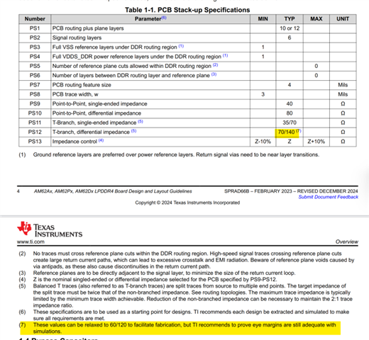

AM625: DDR4 SDRAM Trace Impedance 40 Ω (Ohm) Recommended
The controller and DRAM both provide 40 ohm ODI and ODT settings. These would align with a 40-ohm trace impedance and minimize reflections.
In the guideline for AM62X DDR layout, it mentions that DQ swapping is allowed within a byte. Could you please help confirm if there is any software modification that is needed for this swapping? Thanks
Yes, software modification is absolutely necessary. Please use the DDR register configuration tool : dev.ti.com/.../ to modify the DDR configuration for your board. Check the README link in the tool for instructions. The DQ swapping definition can be changed in the tool:

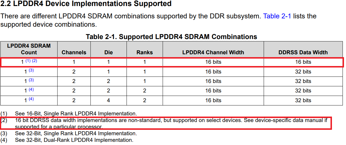

AM625: DDR maximum size configuration in single chip select
AM62x DDR4 supports max of 8GB with 2 ranks, 4GB with 1 rank
LPDDR4 supports max of 4GB with 2 ranks, 2GB with 1 rank

Using 2x LPDDR4 devices
We currently only support one LPDDR4 device. Trying to design with 2 LPDDR4 devices would require routing the data bus to two different devices, which we don't support.
The routing for dual rank would be the same as Fig 2-2 in the DDR layout appnote, with the addition of connecting CS1 and CKE1.

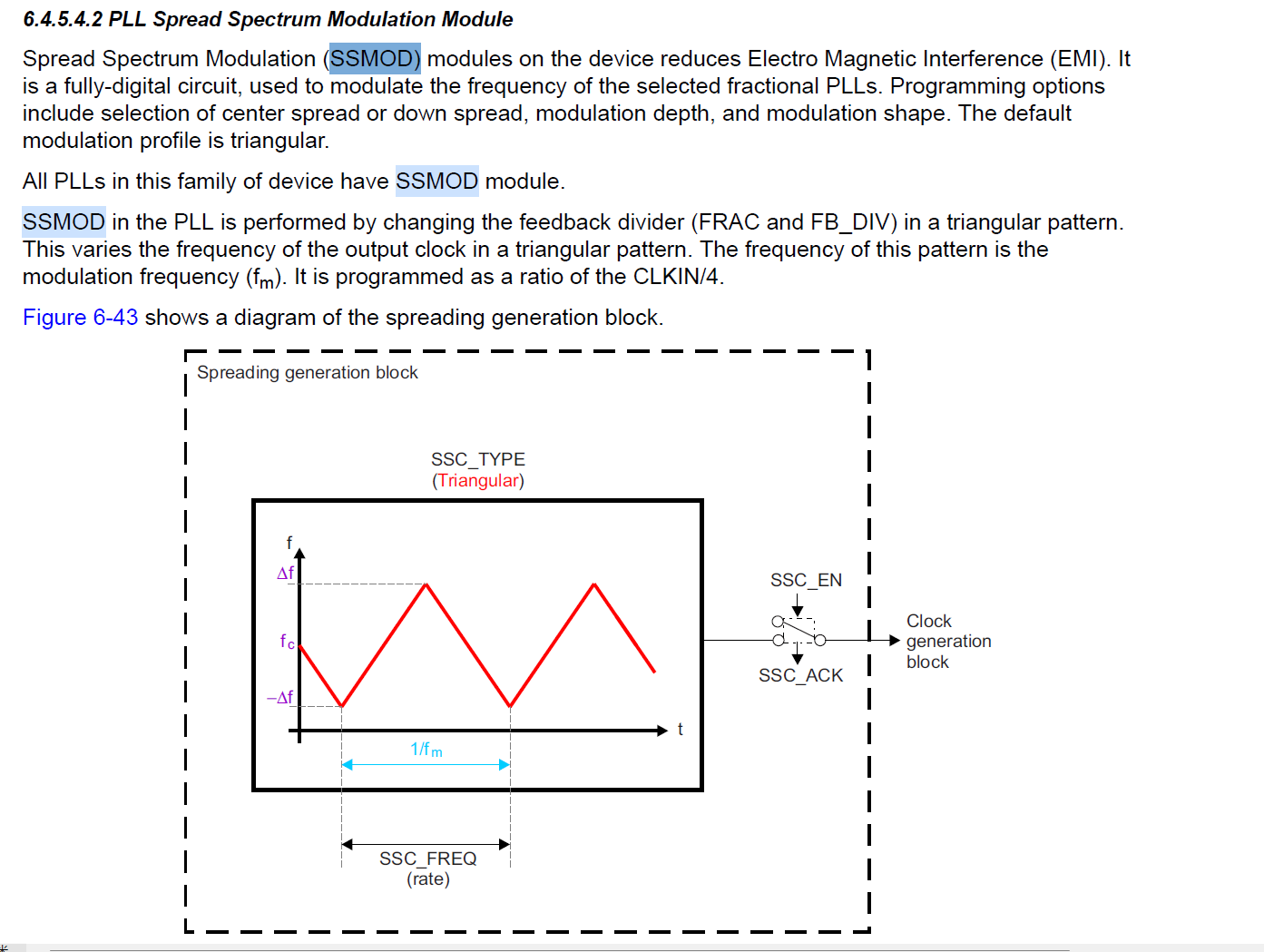

AM625: external and internal spread spectrum oscillator support

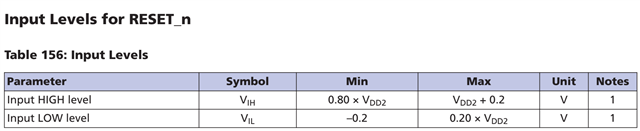

AM625: LPDDR4 configuration and operating temperature
So, for example, if you plan to operate all the way to 125C, change the Operating Temperature Range to -40C to 125C. This also automatically de-rates some of the appropriate parameters (you can see these in the DDR datasheet) (this answers your last question)

Inputs related to DDR attached device reset pulldown.
What is the required tolerance for 10kohm resistor when considering PVT?
We don't spec a tolerance for that resistor. 10K was chosen because the previous resistor on our EVMs was 2.2K which proved to be too strong, and the Vih was sometimes not met for DDR_RESET_N.
If the tolerance of 10kohm is +/-10%, is it met for DDR_RESET_N?
yes +/-10% should be adequate
Additional inputs:
Please let me know the reason that 10kΩPD is OK in no circumstances(device PVT and variation of PD resistance value).
We can not know the drive strength of this I/O because there is no spec in datasheet.
This value has been shown in our characterization across PVT to provide a higher voltage level (vs using a 2.2Kohm resistor) when DDR_RESETn is deasserted during initialization. This provides better margin above Vih for that signal.
We would like the evidence that there is no VIH violation in no circumstances. Please let me know the minimum voltage level in worst condition with PD10KΩ. Or, please let me know the minimum drive level as VOH and IOH.
We don't specifically test this voltage level across PVT. The IO driver in this mode should be able to achieve VOH=>0.85*VDDQ and VOL=<0.15*VDDQ according to the IP vendor. They have checked this over PVT in simulation.

Hi Board designers,
Inputs related to DDR design guidelines.
After reading this version of the DDR design guide www.ti.com/.../sprad66b.pdf, I have several confusions.
1. According to LP4_DRS6 in Table 2-7, the propagation delay of DQSx can be greater than DQ/DM.
However, in 3.5.3.2, 'DQSx delays must be less than the DQ and DM delays in the respective BYTEx' is mentioned. Which design rules should be followed?
2. Besides, is LP4_ACRS3 in Table 2-6 too strict compared to LP4_DRS4 in Table 2-7?
The package delay between DDR0_CK0 and DDR0_CK0_N has exceeded the value LP4_ACRS3. So I want to double confirm.
3. According to LP4_DRS3 in Table 2-7, does CK delay must be greater than DQS? Is 3*tck too loose?
1. Yes, the recommendation is that the DQS pair within a byte should have the shortest delay. As mentioned, the design allows for the DQ/DM to be shorter. We are adjusting the wording of the statement in 3.5.3.2 to align with the table
2. The skew on DQS and CK should be tightly matched as specified in the app note. I confirmed these differential pairs do have different skew requirements as noted in the app note (this was specified by the IP vendor). When performing skew matching, package delays should be accounted for. It is true that the package delay between CK0 and CK0_n is large, but it was recommended by the IP vendor to keep the mismatch in the package, and perform the length matching on the PCB.
3. Yes, CK delay should be greater than DQS to facilitate write leveling algorithm.
Is there is no additional skew requirement between DQs within bytes in table 2-7? We follow the 20ps skew between DQs , including the AM62D package. If there is no strict requirement, we can reduce many snake traces.
LP4_DRS5 in table 2-7 defines a max skew of 150ps. Where are you seeing 20ps?
20ps is the value we refer to some experience of PCB layout.

Hi Board designers,
Inputs related to DDR size:
Regarding the LPDDR4 connection, see
The [AM62x data sheet] (P1/263) states 4GBytes with LPDDR4, but the [AM62x, AM62Lx DDR Board Design and Layout Guidelines] (P22/44) states Max2GBytes. Which is correct?
[AM62x, AM62Lx DDR Board Design and Layout Guidelines] (P22/44) states that it is possible to connect the Dual specification with Single.
In this case, is it necessary to process the pins of the other memory area of LPDDR4?
it is technically possible to get 4GB of LPDDR4 with AM62x, however, as noted in the Layout guidelines, you would have to use a dual rank, dual channel LPDDR4 and only connect 1 rank to avoid splitting the data bus on the board. Thus, you would not be able to access half of the memory.
So the layout guidelines suggests that if you are needing more than 2GB of memory, you should use DDR4.
When using 4GB(Dual) of LPDDR4, do I need to process unused pins?
you can leave most of the unused pins unconnected. The unused DQS signals on the memory should be pulled to opposite polarity (ie, DQS_t pulled low, DQS_c pulled high) with a 1K resistor

AM62P: How to handle DDR pins required by only DDR4 when LPDDR4 is used?
My customer is drawing the schematic of AM62P.
They have question for DDR pins.
When using LPDDR4, how should they handle pins that are only used for DDR4? They checked the document "AM62Ax, AM62Px, AM62Dx LPDDR4 Board Design and Layout Guidelines" (SPRAD66B), but could not find the information.
Their understanding of unused pins when using LPDDR4
DDR0_a[13:6]
DDR0_ACT_N
DDR0_ALERT_N
DDR0_BA0/1
DDR0_BG0/1
DDR0_ODT0/1
DDR0_PAR
DDR0_WE_N
These signals can be left unconnected. Please refer the SK schematics implementation and follow the same.
