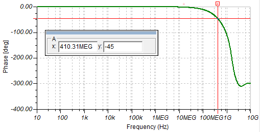

Here is the schematic and graph I used to choose the value of feedback resistor, holding the values of the feedback capacitor and junction capacitor constant at 1pF and 1.6pF respectively:
Although my signal to noise ratio will likely need to be much higher than a measly value of 1, a transient analysis of my graph from 0 to 10ns compared to the TINA-TI noise analysis function yields that noise overtakes the maximum value of my signal at 1.23GHz. Here are the graphs I used to come up with that information:
Which would lead me to believe that the uppermost limit of this circuit's bandwidth is 1.23GHz. But to add onto that issue, the phase graph produced by the AC transfer characteristic in TINA-TI is telling me that I pass -45 degrees at 410.31MHz, (of which I'm assuming based on some reading that the -45 degree mark is a value that helps to determine for what frequency range your circuit is still stable):
And so now, my circuit's "-3dB cutoff" has gone down from 1.68GHz to 410.31MHz.

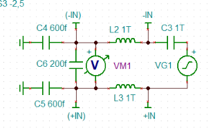

    The stability of TIA is simulated by performing a phase stability analysis. And the bandwidth is simulated by simulating the frequency response and transient response of circuit. By adjusting the component values you will quickly find an optimum between stability and the bandwidth and the step response. The optimum component values are found by trial and error starting from some rule of thumb values from the datasheet or just by experience Relaxed

    Also, I looked at your collection of links on stability analysis. Is there a name or description of this scheme that you appear to be commonly using to probe amplifier circuits for stability?
    I've tried inserting this probing scheme into my own TIA circuit, taking inspiration from how you've used it in your linked threads, and I'm having trouble finding values of feedback resistance/capacitance that will permit a 90fF photodiode model to have both a >1GHz -3dB bandwidth and a >=45degree phase at 0 gain in the phase stability circuit.

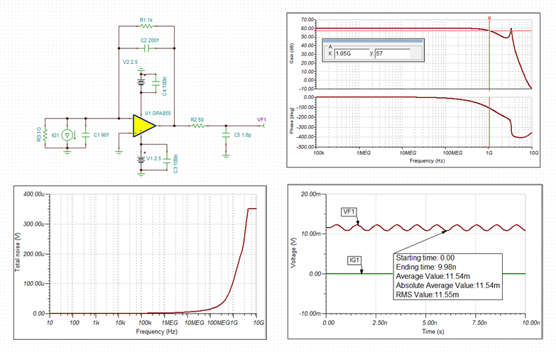

    My initial concern with using the OPA855 was the input bias current being significantly higher than the OPA858, because I'm expecting signals on the order of ones of microamps. (The OPA855 has an input bias current of Typical: -12uA.) My understanding of input bias current is that, when this amount of current does not either come out of or go into either input terminal of the op-amp, the op-amp will not run in the proper operating regime. Is this wrong?

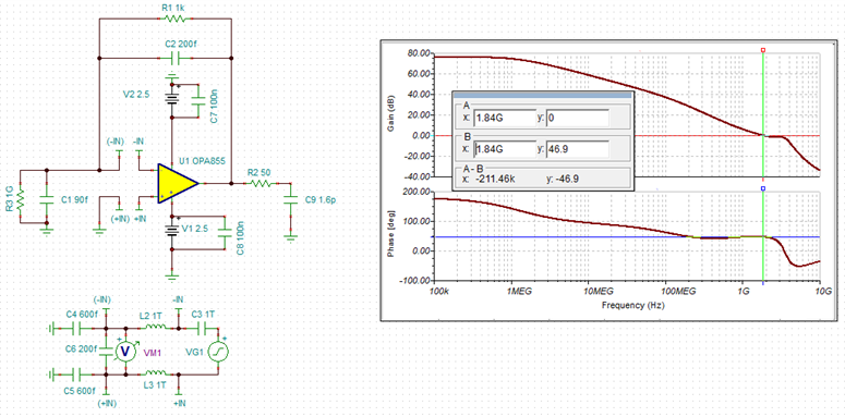

    However, I tried using the OPA855, and using a combination of what I had before and Kai's wisdom, I've reached something I'd like some feedback on:
    • Do these results (AC transfer characteristic, noise analysis, transient analysis, phase stability analysis) imply a stable (albeit fragile?) circuit with a 1.05GHz -3dB bandwidth?
    • What is the reason my Vrms on the transient analysis (0-10ns) begins at 11.54mV, where I would be expecting 1uA to become 1mV after the 1kohm feedback resistor?
    • Should I be worried about the gain peaking after the -3dB bandwidth in the Bode plot?
    • What does a 200fF feedback capacitance imply for the sake of realistically producing this circuit?
      • I've read about sub-picofarad feedback capacitances in The X-Chapters of the Art of Electronics, where the author describes being able to make sub-picofarad capacitances as gimmick capacitors, but I'm worried about the stability.
      • In my case, can the 200fF feedback capacitance be a model of the OPA855's 0.2pF differential input capacitance?
    I appreciate your guidance.
    Gabe

  • Hello Gabe,
      Thank you for your detailed analysis on this thread! Michael brought up the OPA855 because of your chosen feedback resistor. Even though OPA855 has a larger input bias current/ current noise, depending on your chosen resistors, the improvement to the offset voltage/voltage noise might give you overall better performance compared to OPA858.
      For feedback capacitors, 200fF is possible with difficulties; we usually recommend for possible designs that the feedback capacitor must be >= 100fF. There are some techniques to achieve 200fF via using capacitive tee network especially when considering capacitive parasitic from the board:
       Your stability analysis does show >45 degrees which implies stability; but with considering the speeds + board layout this might lead to instability in practice. Extra care will have be taken for board layout especially at feedback/inputs of the device. TIA calculator does agree with your design choices:
      Above calculator is for achieving a Butterworth response (65 degree phase margin, 0.707 Q factor). Are you expecting sub 100fF photodiode input capacitance and will this diode be able to be placed as close as possible to the device input?
    Thank you,
    Sima

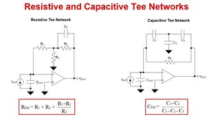

    At present, is there anything else I can do in terms of circuit topology/design to increase the resilience/robustness of the amplifier, so that actual board layout design considerations and techniques can be minimized? Or is the circuit at its utmost capability?
    I'm noticing that manufacturing tolerances across worst case scenarios for a T-network that is equivalent to 200fF lowers the range of expected capacitances from 150fF-250fF to 180fF-220fF. However, achieving stability and bandwidth this configuration doesn't seem likely from my simulations, so I'm also wondering if this route is worth any further investigating (feedback resistor required for stability = 1.4kohm, feedback resistor required for bandwidth = 1.2kohm).

  • Hello Gabe,
      I agree that at present, I do not see any more suggestions for adjusting the circuit. You brought up bootstrapping the TIA to isolate the input capacitance, which does extend closed loop bandwidth. However, for your design of a sub pF input capacitance, there wouldn't be a massive improvement and would add increased complexity with additional parasitic to the board and the transistor would contribute more capacitance than the photodiode.
      I found this resource for extending the bootstrapping which shows an increase in measured bandwidth: link can be found here
      I would suggest trying out the design with the OPA855 EVM. The biggest challenge is stability with photodiode >1inch away from the input of the amplifier which would alter your stability simulations where a different value for your feedback capacitor would be needed. Here is a thread on modifying EVM for TIA, not explicitly stated in the thread but you would add CF by soldering it directly on top of RF.
